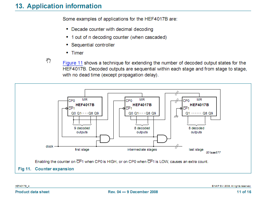

good everyone. i have a problem using a cd4017 counter to count up to 60 or more.
Look at this datasheet, it shows how to connect 4017's in series chains.:)
