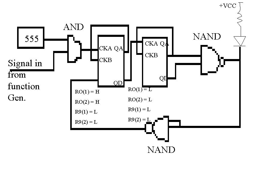

My teacher's Diagram for me
Well, my teacher said this would work but still after patching up everything, the led starts blinking and after 1 minute, just stays lighted up. is there anyway where i can improve on this circuit in the most simplest way?
really million of thanks to you experts out there, or i would be in a lost.

Re: My teacher's Diagram for me
but what about the counting to 100? Your previous circuit doesnt do that. And the way the flip flops are connected is not recommended.
