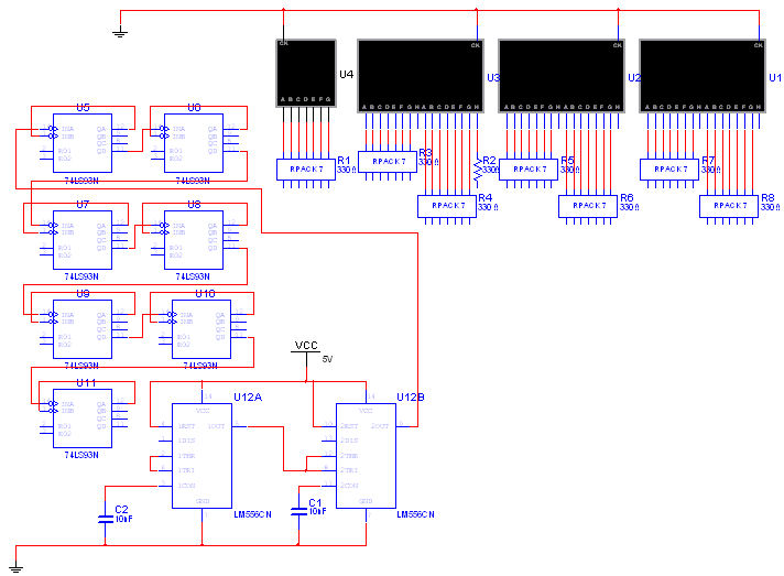

My Final Project for my Digital Class is to Build a HexaDecimal Clock which is due on Monday (20070813) which means that I do not have a whole lot of time (less than 100hrs. I have an idea on the circuit design but the part that I am having a hard time finding is a HEX to 7-Segment Decoder/Driver. The other part that I am having trouble with is the pulse timing. The pulse timing needs to be 1.32 seconds. My problem with that is the wiring of my 555 Timer.
Does anyone know how I can decode Hex to a 7-Segment Display? If so, what device do I use?
Attached is a jpeg image of the circuit designed in MultiSim 9

Not sure of any device as such, you may have to use combinational logic to drive your displays. If you have trouble with this I would be willing to help!
Hexadecimal is counting up to 16 if I'm correct ?
You can use the old TTL 7490 and 7447 IC's for that. If you don't decode the 10 it will run up to 16 or F then inpuls up to the next decade.
Yes Hexadecimal is a base 16 counting system.
But do you want to display in HEX or decimal? If you want to display in decimal then yes th 7447 will do this, however,if you want to display HEX then you may need to look at alternatives, such as combinational logic.

7447
From memory i'm pretty sure that a 7447 will show A-F string as well.
Easy enough to try it out with one decade to see if that set up works.

Unfortunately I'm aware of no single chip solution. Lots of solutions for a decimal clock with TTL or CMOS chips.
If you use a microcontroller it can be a single chip solution and cost less than the TTL or CMOS version.
But it's a moot point as if you've not started by now it's unlikely you'll be able to finish before Monday. How would you get parts on a Sunday?
The only way I could suggest short of using a micro would be a diode or PROM solution. A 4 to 16 decoder like a 74LS154 and a bunch of diodes in a matrix, problem there would be low current drive. The PROM solution would require an EPROM burner.

Before you give up on your original idea try the CMOS chip CD4495. It is a hexadecimal to 7 segment driver. I've used them alot in the past. You can google for the part number for many places such as
www.4starelectronics.com.
This should get you on the right track. Personally I like the Dragon fly project board. DOn't own one but it does look good!
AlarmMan
PS While you are looking for those chips also try to get CD4520 binary up counters. There are 2 counters in each chip so it should make the total chip count alot less.
The CD4495 may be hard to come by, 4starelectronics turned up nothing. Sounds like a nice solution though. I couldn't even find a datasheet for it.
