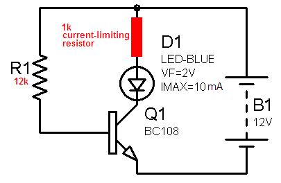

Ok, so I'll show you my problem with an example,
Here's it is:
I want to drive a load at collector of a BC108 (the load happens to be a resistor or a led).
We know that the said LED needs 10mA to safely be lighten; it has an operating voltage of 2V in our example. So we know that Ic has to be 10mA and we have to have 10V drop on emitter-collector of BC108.
As you mentioned every transistor has a different hfe even if they are the same.
Now please tell me how I determine the Ib while The hfe is not constant for a specific transistor?

You want a switching transistor to be saturated.
hFE is not used when a transistor is saturated, hFE is used for an linear transistor amplifier that has plenty of collector voltage.
The datasheets for all transistors show that they saturate pretty well when their base current is 1/10th the collector current.
I changed your schematic so that the base current is 1mA and the collector and LED current is limited to 10mA by a 1k resistor.

But please tell me why you could put an exact 1k Resistor on collector while there is a led in series with it and the led has a resistance which adds with 1K resistor so we do not follow 1/10th law??
Please tell me if I could use a Pot instead of R1 and change its value so that I get 10mA at collector for the led too?
And please tell me if I could use any resistor lower than 12k for base yet remain at Saturation situation?

The power supply is 12V. The LED is 2V. The transistor is saturated (turned on hard) with a voltage drop of only 0.05V.The current for the LED is 10mA.
Duh! Ohms law says that the current-limiting resistor for the LED must be (12V - 2V)/10mA= 1000 Ohms.
Yes, of course. But it would simply waste power. Use 10k.
A little transistor is completely saturated when its base current is 1/10th or more of the collector current.

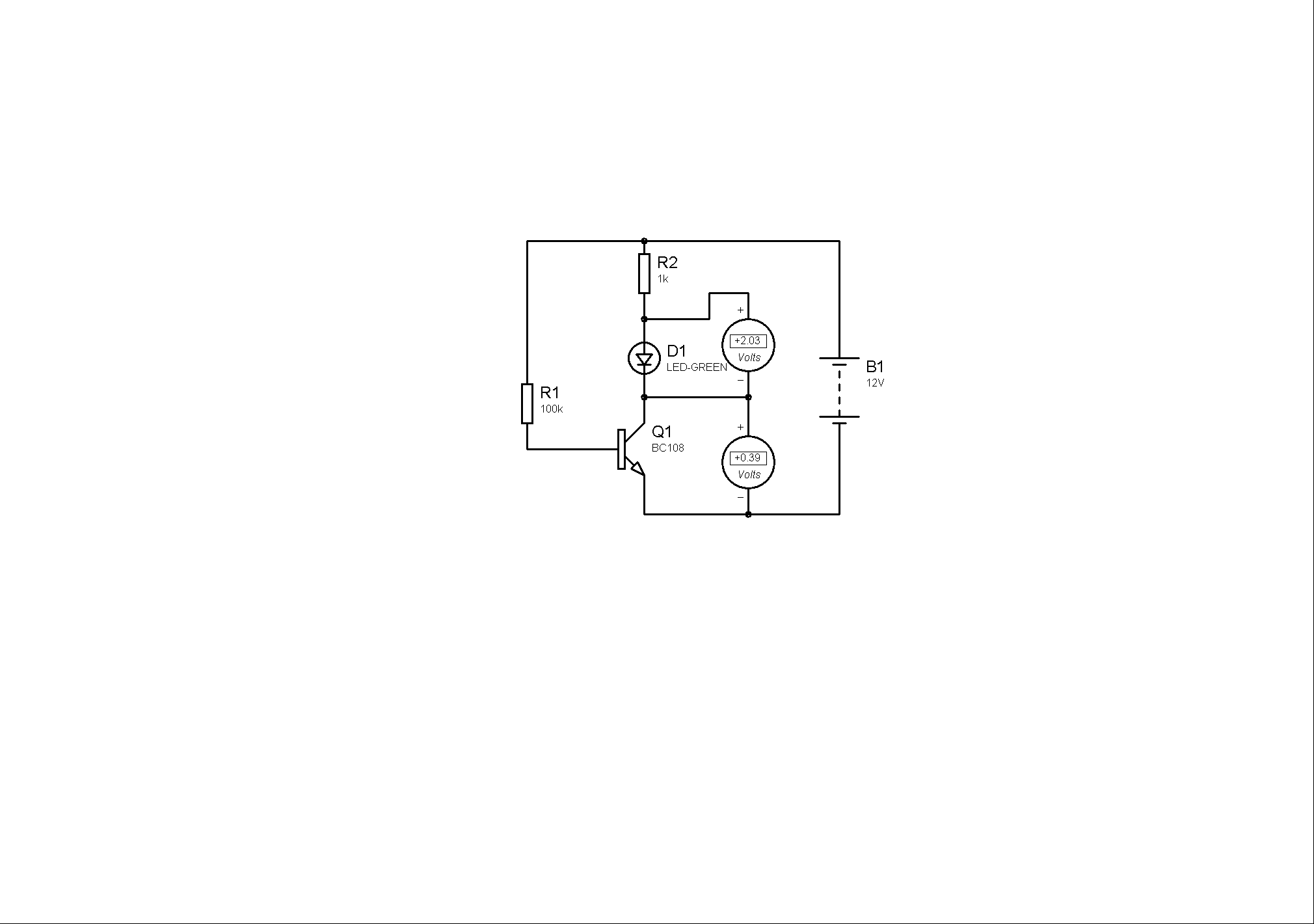

Your transistor might be a typical one as shown in the datasheet.
But yours has a base current that is only 1/88th of the collector current with a saturation voltage of 390mV, and the one in the datasheet has a base current that is 1/20th of the collector current and a saturation voltage of only 70mV which is much better.
Your circuit probably will not work with many BC108 transistors that have less than typical gain.

I am wondering why my transistor shows just 0.30V at CE while the base resistor is 100K ie collector resistor is 1/100 base resistor?
