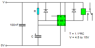

This can be done using a 555 timer and a relay.
Ok thanks. What way around does that circuit operate? Ie, while the 555 timer is counting down is it holding the relay closed (fans off) and once the 555 has finished it releases it? or is it the other way around?
If it is the latter i am concerned about the 555 IC burning out as it will be running for quite a long while -all the time the fans are operational. I have made 555 circuits before to create a pulsed output to pulse a transistor and ultimately trigger an ignition coil. but i found some of the 555's burnt out after a couple of days?
Also 'T=1.1*RC just a guess but does that mean Time = 1.1sec * resistor value*capacitor value? I need about 15~20 second delay.

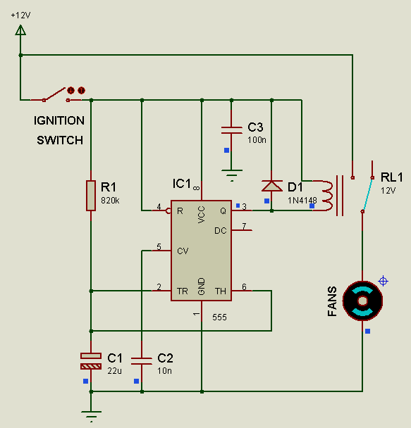

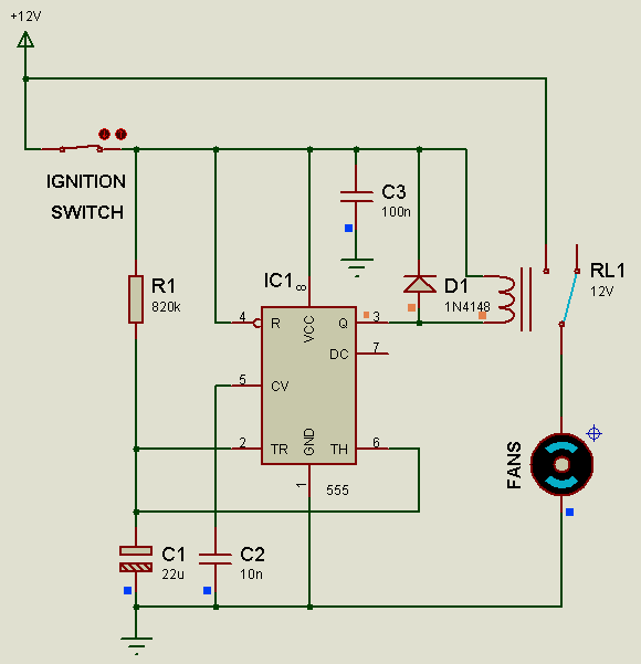

Hi Ryanrs,
the circuit can't do anything if the ignition switch is off (pic1). As soon as the ignition switch is on timing starts with high level output at pin3 (pic2). When timing terminates pin3 goes low, thus enabling the relay which in turn switches on the fans (pic3).
You should be aware that the maximum supply voltage of the timer IC (NE555) is 16V. DC supplied from the car alternator is pretty dirty and full of spikes (sometimes up to 40V).
Take care of good filtering by using properly rated electrolytic caps and transil-diodes to eliminate those spikes.
The timing formula put down by hero999 is used: T(sec)=1.1*R(Ohm)*C(F).
The suggested circuit times out after ~20 seconds.
Besides the three pictures of the circuit I attached a datasheet of transil diodes.
