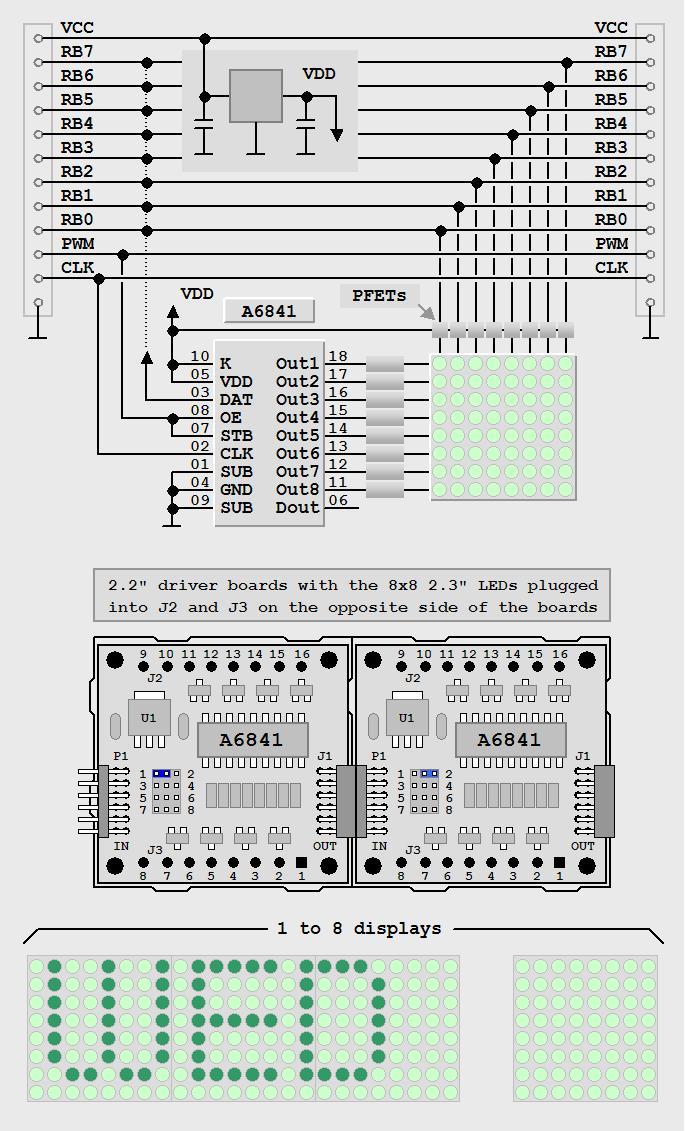

Forgive me but I don't understand why you need to switch power to individual 8x8 LED planes when you can easily turn off all 64 LEDs in a single plane with the microcontroller.
Also, consider using the Micrel MIC5821 or MIC5841 serial-to-parallel sinking driver IC instead of the ULN2803 sinking driver. You'll find you can easily control all eight 8x8 planes at a 12.5% duty cycle with full brightness using a single microcontroller, eight MIC5821 sinking row drivers, and eight IRF520 sourcing column drivers. As a bonus, drive the Output Enable lines on the '5821/'5841 row drivers with a PWM signal at a period equal to the individual column scan rate and you can easily control the brightness level anywhere from full brightness to black.
The example depicted below actually uses the 8 column driver lines temporarily as data lines to load the eight driver shift registers in parallel during a 1% minimum PWM off time during each 1.0-msec column scan period. This drastically reduces the number of microprocessor I/O lines required to drive 512 LEDs.
Good luck with your project.
Happy Holidays. Regards, Mike

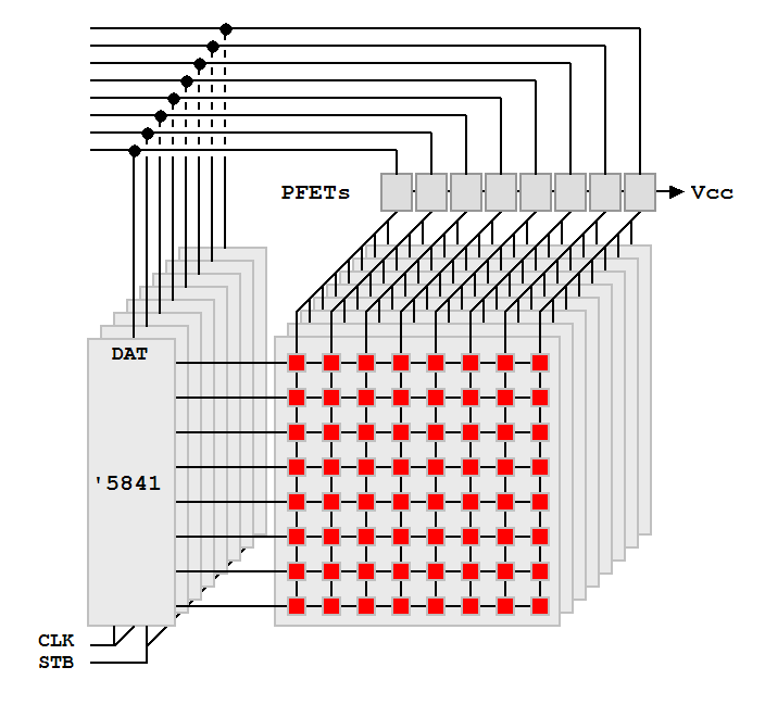

First off, thank you very much for taking the time to comment illustrate your answer so well - it's much appreciated.
My idea regarding the switching of planes was to accomodate multiplexing by planes of 64 x 8 to keep the duty cycle as high as possible. This way up to 64 led's could be on at a time, so cycle time would be 1-8. I also thought it might minimize driver complexity. Also, I'm not certain if this is an issue, but in order to keep the 3d led matrix assembly as visually minimal as possible, I wanted to address by column and plane... see **broken link removed** as an example of that. I would not have the luxury of electrical connections to every column in 2d arrangement.
I will have to digest your suggestion a bit, specifically as I'm not familiar with the 5841 you suggest, though I do understand your point of shift registers.
Looking at your illustration, does this mean I would need one driver board per plane, requiring 64 pfets? I see your comment says only 8 pfets, but the boards seem to indicate 64.
Edit... nevermind that too, I figured it out. Makes sense now, very clever. ;-)

I apologize. The design I suggested does indeed drive a "plane" of 8 columns as you depict. I just wasn't looking at it the right way. The example drawing I provided shows a PFET for each column but it's very simple to implement a single set of 8 PFET drivers for the entire 512 LED matrix.
The 15-ma output limit on the '5540/'5541 would be fine for a non-multiplexed design but you'd need a bunch of them. You need quite a bit more drive capability on a multiplexed display with a 12.5% (1/8th) duty cycle. A peak current of between 80-ma and 160-ma per LED would be required for full brightness.
Addressing by "column and plane" is simple enough in software. Define your matrix array anyway you'd like to make it easy to manipulate in your program and have the interrupt driven multiplexing driver pull data from the array as required to drive your hardware. Interestingly, my PIC driver for that example uses 5x7 character font "column" data for a moving display and I have a small bit of code in the interrupt service routine that formats 8 bytes as "plane" data for loading the 8 driver shift registers in parallel during the next interrupt cycle. The interrupt driver uses about 50.0-usecs every 1.0-msec interrupt (5% of the overall processing time) so there's ample time to manipulate the display data array in the main program.

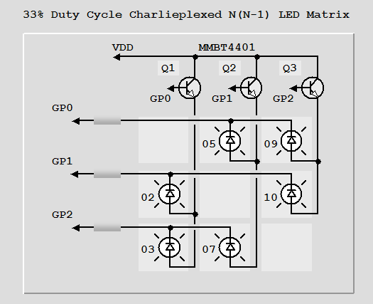

Not to derail the thread too much, but I was wondering if anybody has seen a matrix display that uses a "charlieplexed" setup? Maxim obviously uses it for the character displays, but it seems like a short intuitive leap to start using it for larger display assemblies.
In the case of volumetric displays, each column would be driven by a 3 wire(=>6 leds) or 4 wire(=>12 LEDs possible) connection. The advantage is that essentially each column uses 3-4 wires that run down the length of the column with no wires going across to other columns. Instead of doing the usual matrix wiring routine, you would end up with each column being an individually wired "spike" sticking out of a main array board.
The tradeoff is that you end up with a lot more pins to drive, *but* the duty cycle is also significantly reduced - a standard $2 16I/O microcontroller would be able to drive 2 full 12LED columns, using only a couple current limiting resistors. The really neat thing would be to then do some brightness compensation on a per-led basis, or just have some real grayscale stuff going on.

The bigger trade off is every pin has to source AND sink current, which basiclaly means you can't use high currents (no drivers).
Well, the uC would have two IO lines per "charlieplexed line" - one with a current limiting resistor, the other without. Alternatively a series diode and a resistor would work too, and reduce the number of required IO's to 1 per "charlie-line", allowing the use of external driver chips.
Microcontrollers are getting into the $1-$2 per chip range- an array of 30 of them isn't *that* expensive - and makes for some interesting software.

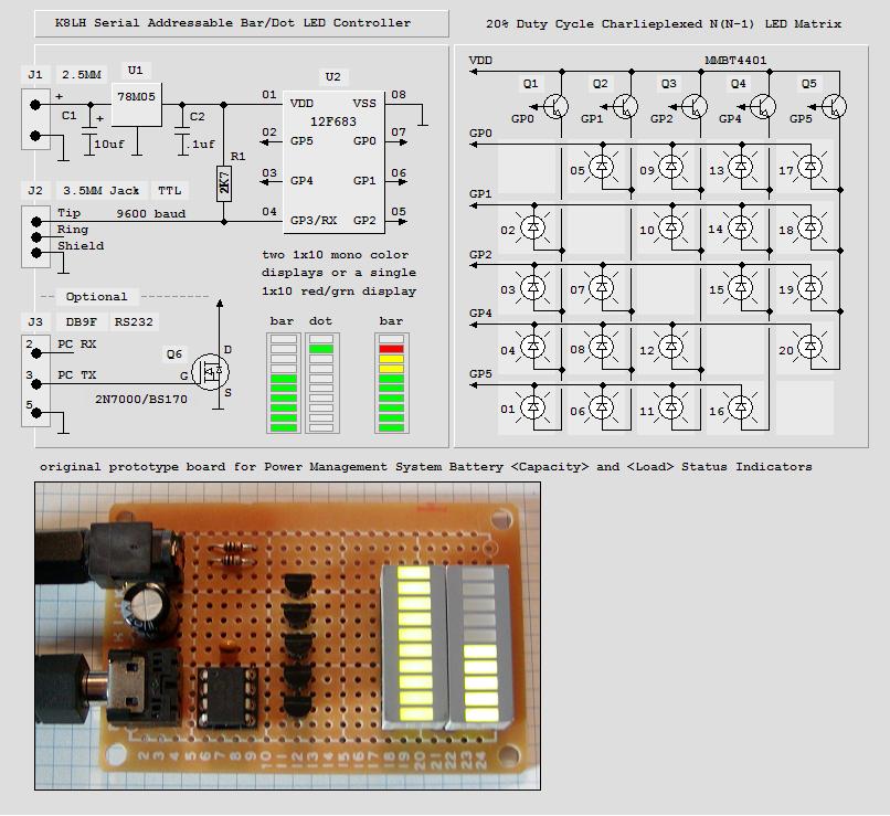

Unfortunately the PIC I/O sink/source current spec' limits the brightness on a charlieplexed matrix. Though you can get very decent brightness with smaller matrices (higher duty cycles).
You also really need to buffer the column driver pins for consistent brightness when lighting more than one LED in any particular matrix column. This then would require six wires running up a six LED cube column instead of three wires.
I suspect the Maxim Charlieplexing driver chip pins can sink/source more current than PIC pins.

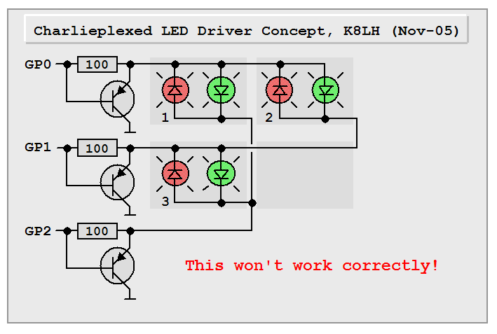

I tried this last year (drawing below) thinking it might be a clever way to drive the 2-pin style Red/Green LEDs. Unfortunately the "folded" matrix provides a forward biased two LED series path for each LED that you want lighted. Bummer!

Not sure what you're talking about here. Why the Schottky diodes? Perhaps a drawing?

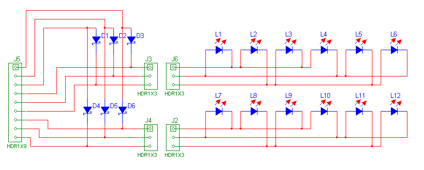

Now I'm confused - your Nov-05 diagram is just a normal charlieplexed array - with a minor hitch that there are two different forward voltages present - so if the Vf of the red is < 1/2 of the Vf of the green, you'll end up with extra red LEDs whenever you turn on a green one?
In any case, I now remember why I don't like switching schematic drafting programs.. eh, enough grumbling:
I was talking about a configuration for a 4 wire CA, but it's easier to draw a 3 wire one. Current is sourced through pins 1-3 of J5, and sunk through pins 4-9.
Normal diodes could be used, but might as well specify schottky's. Some big mosfets are shared among all the CA's, and the current is sunk with some dedicated LED driver chips.
As for whether wiring up the LEDs in this manner is manufacturable ... dunno.
