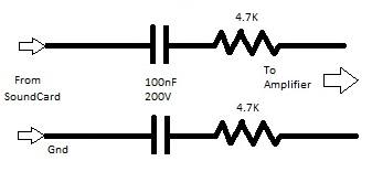

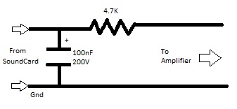

Colin: i want to use this with my computer sound card and amplifier to protect and isolate my sound card, could you please draw the connection for me.... what i understand is like attached image (for each line).
Thanks in advance...
