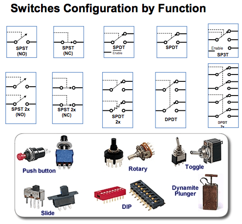

be80be, I like that. My motor is 3.7hp "running". But I think that is only on-off. I need on-on, or in other words, a double throw, DPDT, I think that is DPST. Do you know if they make a DPDT version, or am I missing something, is there a way to make the version you linked to work as a dual throw so I can switch power between going to the air compressor and the RC charger?
The link i posted is the right switch its wired as the drawing shows
There SPST x 2
Like this better picture this is 40 amp one motor rated
It would work just be careful hooking it up. I'd go to home depot and get one like I showed in the picture.
So either I am really just not seeing it, or the switch you linked to will not do what I want. I am pretty sure that the switch in your link when set to off will not make a connection. I need a switch that will make a connection in both positions, in position one, it connects the load one to power and load two is disconnected from power, then in position two it connects load two to power and load one is dissconnected. I do not see how the one in your link would do that. I think it would just connect load 1 in position one, then connect nothing in position 2. Am I mistaken?
Guess I should of read your whole post
You need a switch that is dpdt 2x with center off the one you posted https://www.amazon.com/dp/B003AUIRNY
That will work sorry I should of read more.
Hey, no worries...just wanted to make sure I wasn't missing something. Thanks for your help! You really did help because your original link is what lead me to the DPDT switch by Levington. I already ordered it.
