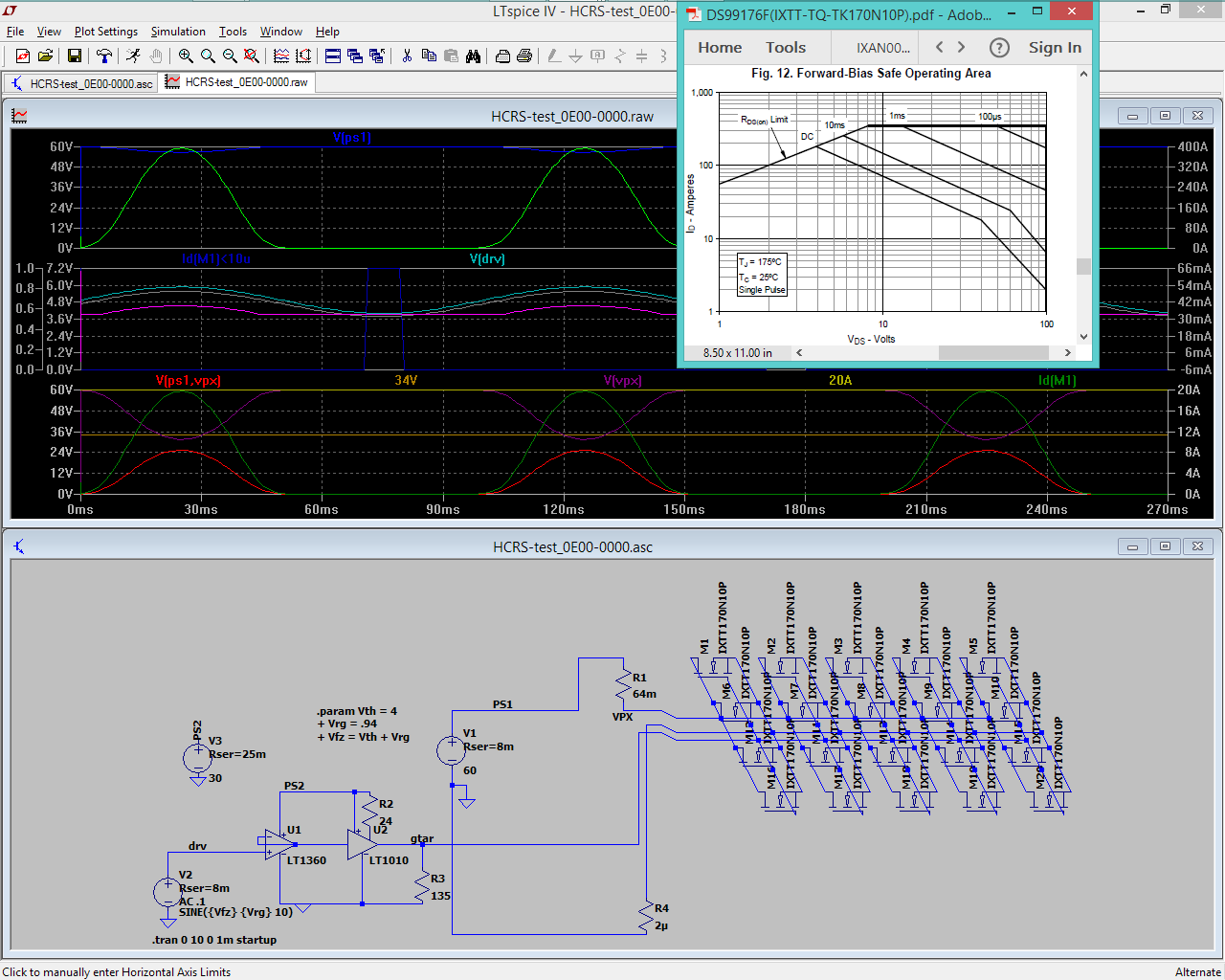

Ive been looking for a 3v to 13v 150a circuit that can supply a load that's ~60mohm for some testing purposes.
This circuit (with more transistors or higher amp capible ones) jumps out to me as being suitable and suitably easy to put together.
Couple of questions here; the Vin on the schematic is too high, will it work with lower voltage?, is the base current/voltage too high to use a surface mount momentary switch trigger after the pot?, and will it function properly with such a low resistance load?
Im hoping it'll work, but if your answers are no, yes, no.. could you point me in the direction of a better circuit please
I've got a sizable heatsink with a micro fan to mount it to, though the circuit can't be more than 5mm proud of it.
As always, any help is greatly appreciated.
