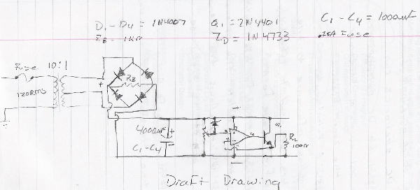

Here is a hand drawing of my regulated PS, and it can be modded to run heavier loads, please note I drew the cap is upside down but showed correct polarity. I also wrote the turn ration backwards, hey I drew this at 3am. Well I guess the turns ratio is right NM on that.
Since resolution is limited the + sign turned into a - sign on pin 7.
Hi Juglenaut,
About your power supply:
1) What is the purpose of your pot? To blow-up the pot and the zener diode?
2) Doesn't the circuit produce a lot of ripple, since the zener diode is referenced to the positive of the supply instead of to ground?
3) What mod do you suggest to it for it to drive a heavier load with more than only 50mA?
Actually oh skeptical one this circuit got top grade in the class.
99.8% regulation 0.4% ripple with 4kuf with 1k bleed, 64.5 mA total current DC.
The pot is to set the 5.1 volt typical zener at 5 volts exactly for reference to a high Zin op-amp. Only a few mA goes through the zener and the 50k pot.
The basic idea is in the book "The Art of Electronics" Cambridge University.
Seeing how the load is mostly over the transistor and the bridge rectifier. I think increasing to a higher spec component would do the job. The op-amp I used can take 24 volts +- at pin 7 and negative 24 at pin 4. I am able to run a 4 ohm load with no over heating into distruction as is.
Please note that the pot is acting like a 50k resistor to ground from a 12 volt source in which I didn't draw in a first drawing, as it was a step towards a final stage. I am so sorry I have nothing better to do than to post all day I would have caught it but I need to work to make money and time is limited.
Why referance the zener to ground directly, wouldn;t it be the same by referencing to positive?? It doesn't need to be, if the electric simularity is referanced to ground through a resistor. In effect you are wrong by saying it is not referanced to ground when in actuality it is very well referanced to ground and positive though a set amount of resistance.
Sorry, but I agree with Audioguru, if your circuit is as the drawing shows?, it's a really crap design, and wouldn't work well. If you've made a mistake in the drawing?, fair enough - but as shown it's not a practical usable circuit.
BTW, what year are you in?, I'm presuming school rather than Uni?, and electronics teachers in schools mostly know next to nothing (or less than nothing?) about electronics!.

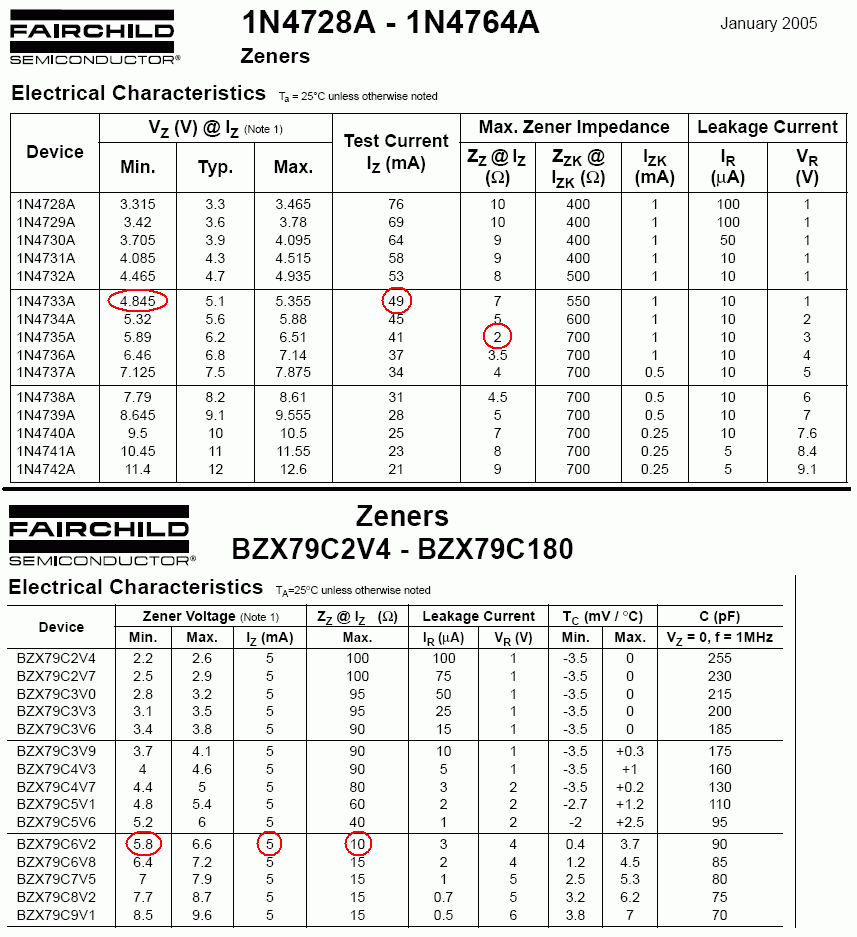

Hi Juglenaut,
You can learn things only if you understand them, so I'll explain a few things. Then you can teach your teacher like I did.
I'll point out problems with your power supply schematic and sketch an improved one later. First let's select a zener diode:
1) The 1N4733 zener diode that you used has a minimum voltage of less than 5V, so is not suitable for use in your circuit that doesn't have gain.
2) The 1N47xx family of zener diodes are tested and rated with an operating current of a whopping 49mA!
3) The 1n4735A 6.2V zener diode would have been a better choice because:
a) Its minimum voltage of 5.89V exceeds your 5.0V requirement and can easily be reduced with a pot across it.
b) Its maximum zener impedance is less than 1/3 that of the 1N4733 (the lower it is, the better the voltage regulation at its operating current).
c) Not shown on the datasheet is the voltage change with temperature change of the 1N47xx family. The 6.2V zener diode changes its voltage with temperature change less than the 5.1V one.
4) I would have used a BZX79C6V2 zener diode because it has a minimum voltage that exceeds your requirement.
5) The BZX79Cxxx family of zener diodes are tested and rated with an operating current of only 5mA.
6) It has a very low zener impedance at its operating current.
7) It has a low voltage change with temperature change.
