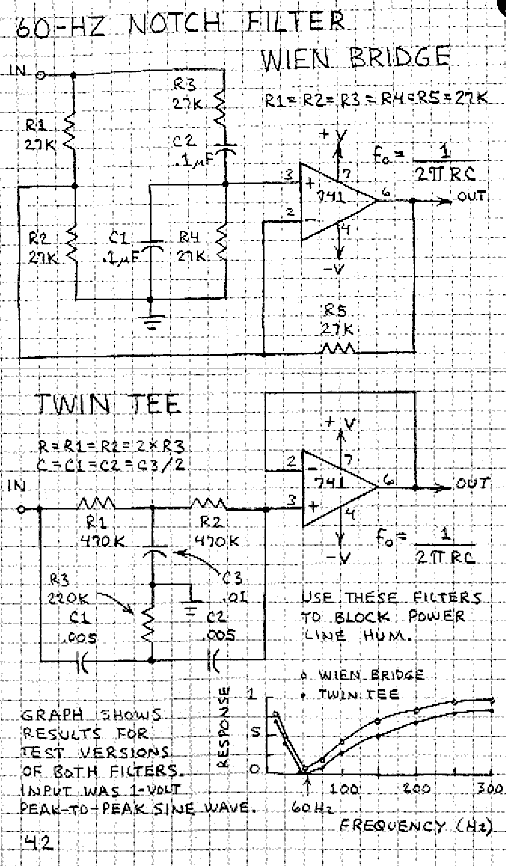

From Forrest Mims mini-notebook Op-amp IC circuits.
Sorry about the quality.

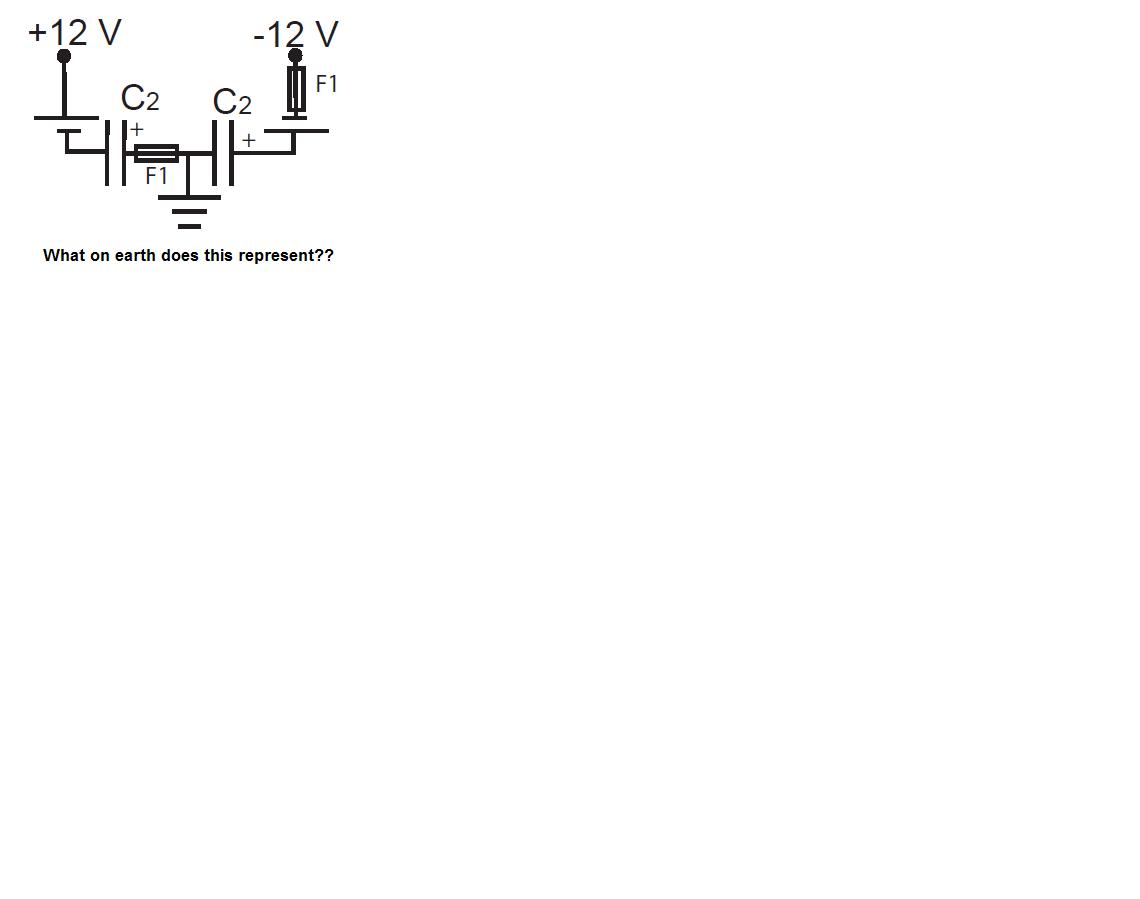

An older version of the schematic is attached (I don't have an updated one at school). Basically we added a high pass filter on the positive voltage line for the JFET and changed Rhp to 220k from 2meg. We've had some serious challenges where I think the LT1115s became saturated. That issue is more or less solved I think.

However, I have had a look at you LT1115 circuit and re drawn it a bit. Some of it may seem a bit pedantic but in its original form it was a bit obscure, going on bizarre in certain areas, notably the power supply. I am at a loss to understand what that actually represented!
I have tried to show how I would connect things up as a system to minimise noise.

I think your redrawn version of the circuit is accurate, yes.
The power supply, as I'm told, has the capacitors because they more readily provide current than do batteries. That part of the circuit is something my adviser designed from someone's advice with a stronger background in electronics than my adviser or I have.
The wires you recommended to twist are twisted along the majority of the wire, with 5 or 6 inches more or less exposed at one point.
