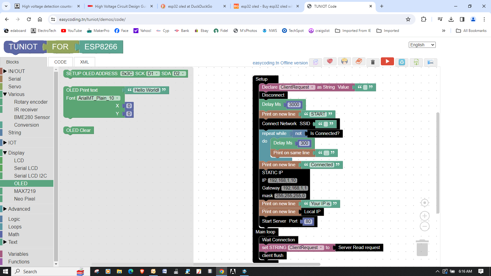

Display could be OLED. Could consider using Tuniot on ESP32 module with
OLED display to get count on web. Example of what it takes to create server/
client interface to WiFI, this is block programming code. Tuniot converts your
block config to Arduino Code, and uses Arduino programmer utility to program
module. So you could have local count on module display as well as net interface
using IOT type server for interface to user, eg. phone or PC.....
Use the interrupt block in Tuniot to detect presence of AC on pin, to increment a counter on
first detection, and then idle until AC disappears (essentially resetting detection loop) .....

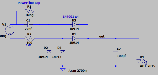

Not what you want but, just for ideas.
I am using a 22nF 3000V capacitor to divide down the HV AC down to something that will light a LED.
22nF=20mA in the LED, 10nF=10mA, 4.7nF=5mA (at 2kv rms 60hz)
The LED will reduce brightness with reduced voltage. So 1kv= half current.
I have a simpler version of this if you want less parts.
R1,2,C1 are special and not just any part.
ps
It works just fine with C2 removed. I have a version of the LED that allows D1,2,3,5 to be removed.

Thanks for the schematic it's definitely a good start for me better than where I was with no ideas. I could always work on replacing the LED indicator with some kind of counter.

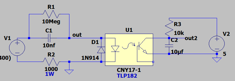

Another idea.
I am using a TLP182 opto isolator to keep the HV away from people. Note the schematic shows a DC isolator but use an AC isolator. D1 and U1 are one part using the TLP182 or any AC isolator. The isolator will hold off 3kv if thinks go to hell or someone reverses the input leads.
A AC isolator has two LEDs in it so it does not care which way current flows.

Yeah I like that idea Definitely makes it safer I didn't think about that Thanks for the idea
