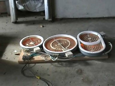

I use a 4.6 kW heating element from a range in series to limit the current to 20 Ampères.
Not for a tesla transformer but for melting sand and other experiments.
4.6 kW element
I use this element(s) often on 240 Volts experiments in series with the equipment under test.
Made up from 3 stove elements picked up from the inorganic collection on the side of the road.
Cost 0.00
Look on my YouTube channel under iron sand melting where you can see it in use with a experimental 20 Amp arc furnace.
