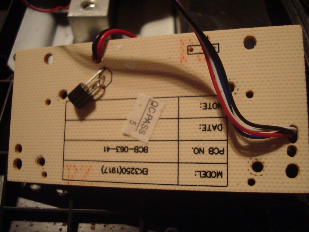

Sorry for the long delay. Here is the image.
If you're lucky the amplifier for the weight sensor signal is not underneath that blob. You'd have to probe around with an oscilloscope or a multimeter while pressing up and down on the scale to see if you can find a trace that carries the analog signal, which you can feed into your own ADC and log it that way. Looks like the row of pins above the blob in the picture is the LCD connection if you still want to go that route, but that picture is so blurred and you didn't take one of the other side of the board it's hard to tell anything.
Use the macro function on your camera (Usually a flower icon) so we can see the PCB better. Do the 4 wires on the left go to the load cell? What is the part number on the 8pin SMD IC?

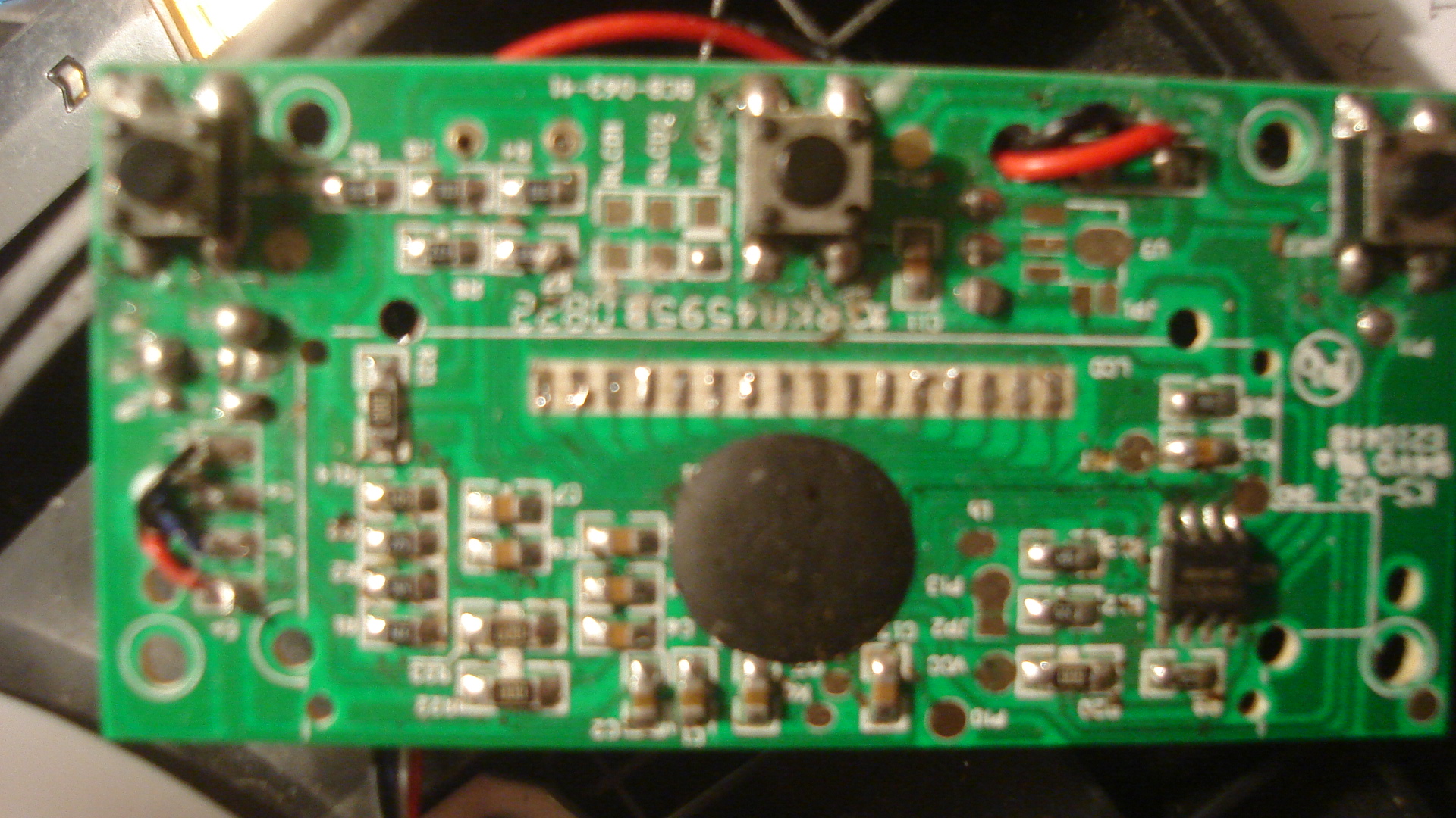

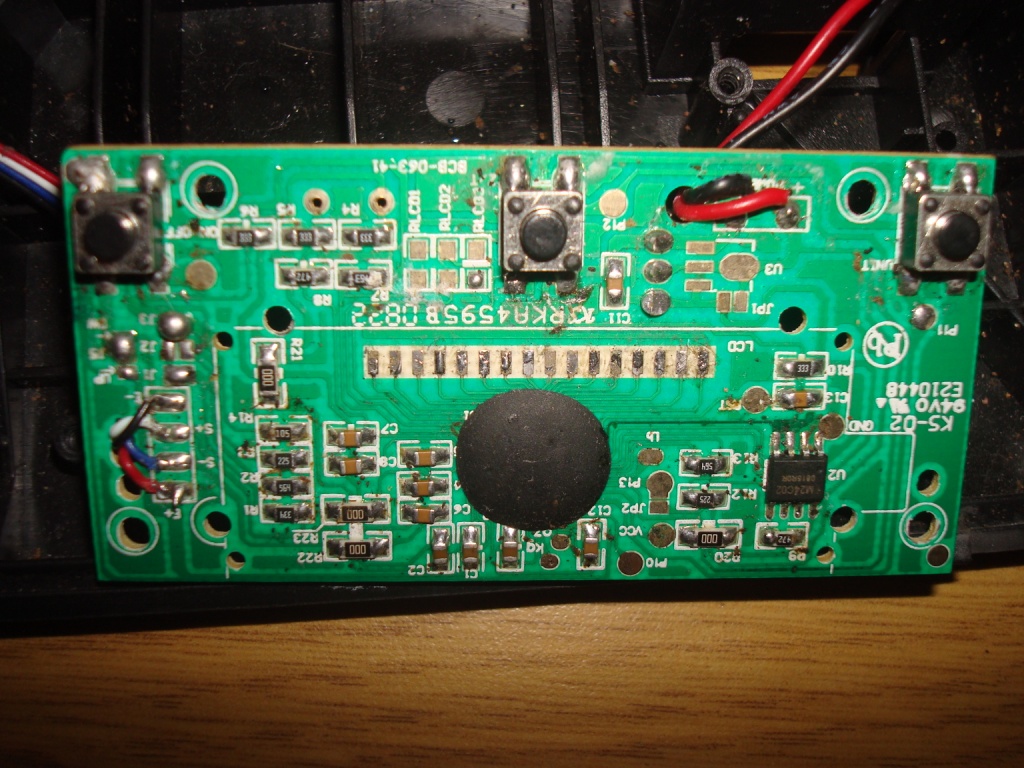

The 4 wires on the left do attach to the load cell. I have attached 2 more pics. Any ideas about an ADC?

It looks like the sensor wires ( S+ & S- ) go straight into the epoxy blob IC. You could measure the voltage between S+ & S- for different weights and then use a differential amplifier to reference the voltage to ground for your ADC. It looks like the calibration table is stored in U2 so the output of the load cell may, or may not, be linear. How much resolution do you need?

If you mean the 4 wires from the load cell, they do not go directly into the epoxy blob IC, but are soldered onto the pcb on the left(look at the first of the last images attached previously).
Yes, but the wires enter the PCB, go through 2 zero Ω jumpers and into the epoxy blob. There are some bypass capacitors in parallel to the lines (And maybe some resistors- can't tell from the image), probably shunting noise to ground, but the traces on the PCB appear to go straight from the wires to the blob. ie: There is no OpAmp between the load cell and the blob.
