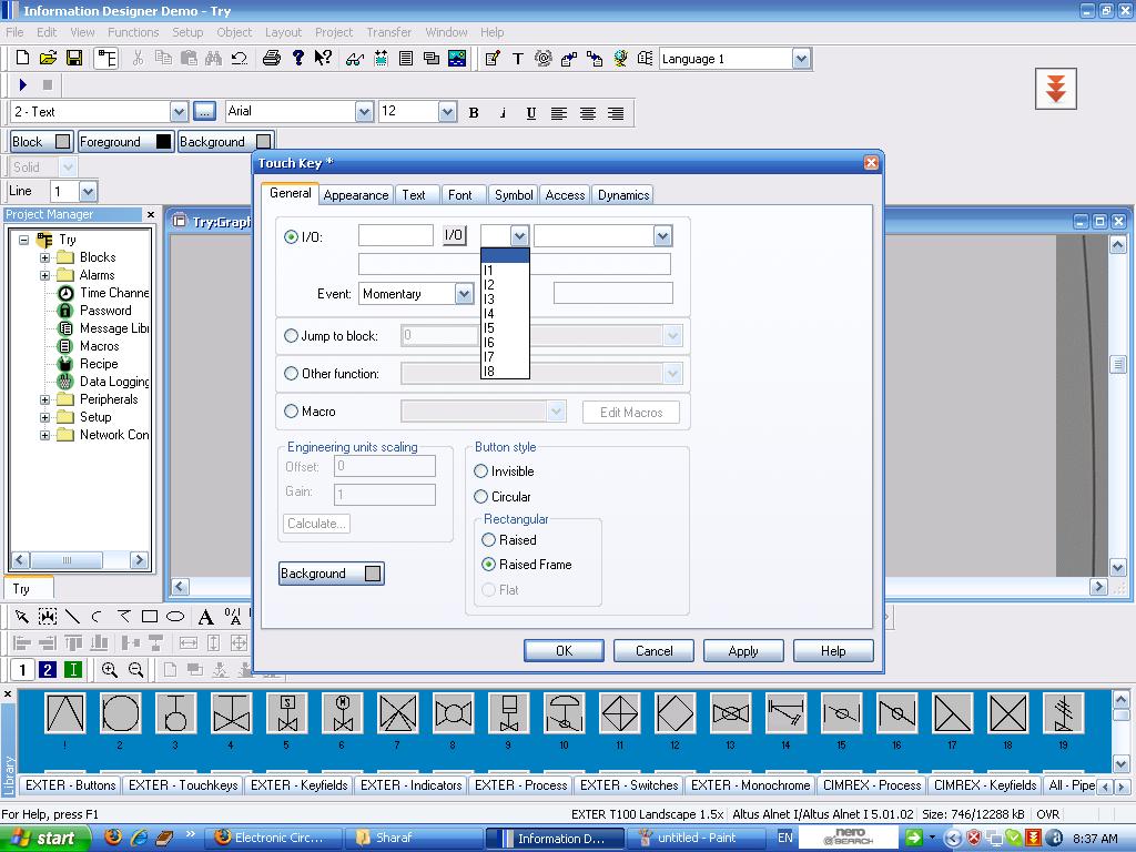

I'm a newbie to HMI operator panels programming. I'm asking about the addressing of the objects that you insert in the HMI operator panel designing software, What is the principle of addressing.... Shall it have the same addresses that I assign for my PLC operands? ... If you have any reference that explains the general principle of programming please send it to me

Thanks for your helpful reply jnnewton, but I'm going to be more specific, I'm using an Exter T100 touch panel, a product of Beijer Co. , as an HMI. The PLC that I'm using is not famous enough, it is PICCOLO PL104 , a product of a Brazilian company called altus.
The Exter T100 gives me ways of addressing like M× & D× and I× . The operands that I'm using in the PLC takes the format %M×××× .Does this mean that I should use the M addressing type in the HMI.
In the attachments you will find a picture that displays the configuration of a touch key object in the HMI.

well, although I cannot see more, I can see that from your picture, your Ix's are inputs, that would lead me to believe, although I have no way to be sure without a manual, that the Mx are coils (m is used as coils in some other plcs) and I would guess that the Dx's are for data. That would lead me to believe that the coil in your plc named M0001, or whatever your plc uses as a prefix for coils would be changed by a tag in your hmi called M0001 and an indicator for input 1 on the plc would be read by the tag in your hmi named I0001, although you should be aware that there could be an offset of one so that I0000 in the hmi corresponds to I0001 in the plc or vice versa. I would need a software manual for the plc and hmi to guide this any further, and would be willing to take a quick look if you need the help. I have gotten so much help from this site, I hope that I am / can do the same for you.
