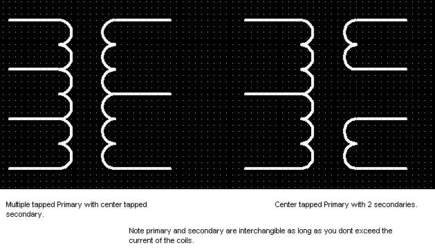

so is there a way to tell the (duno the name, the word that is used for how much it converts the voltage) with just a volt meter and an ohm meter? i can use the continuity checker to see which are the same coil, but then can i use any 2 coils to make it transform?
All the coils interact thru the magnetic field, so you can use any two for the transformer. The 3 wires on one side may be a center tapped winding. The ohmmeter can confirm that. The 4 wires could be taps on one primary winding, or could be two seperate windings. Again, the ohmmeter will tell.
Your looking at the resistance in the ohm meter. On the three lead side measure the resistance between each line. Two should be about the same with one pair having the highest restance of all.
example
wire 1 to wire 2 three ohms, wire 1 to wire 3 seven ohms, wire 2 to wire 3 four ohms.
This would show the ratio of windings between any 2 points, as in above. 1 to 2 would be aproximately half the amount of windings between 1 and 3.
As for the four winding side a simple check for contenuity will tell you if its 1 coil with 3 taps (you will be able to measure resistance between any of the 4 leads), or if its two seperate coils(each pair will show some resistance but you will read infinite between the leads of 2 seperate coils).
Your applications is probably going to need a step up transformer, Id imagine your using a source of 5-9 volts correct? If you are wanting more voltage on the secondary then your source you need to use a transformer configuration that has more windings on the secondary then the primary.
