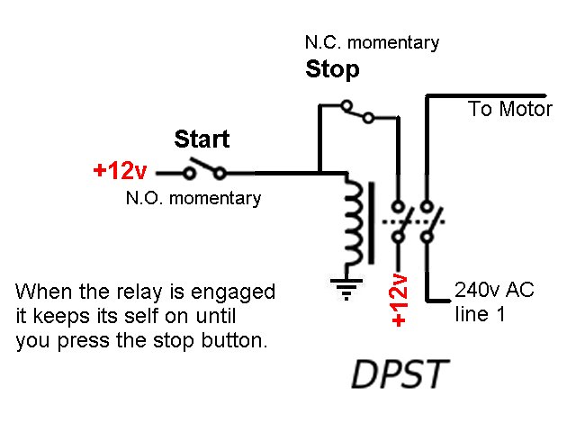

i want you guys to help me to do what is referred to as latching on /holding on of electric motor.I have read extensively on the subject but still cannot find my way.
I want to wire the relay/contactor such when the start button is pressed,the 240 VAC motor will remain on and continue to spin round after the finger is removed from start button.
Can a normal relay/contactor be used for the task ?If not , which one?How is the wiring supposed to done.
