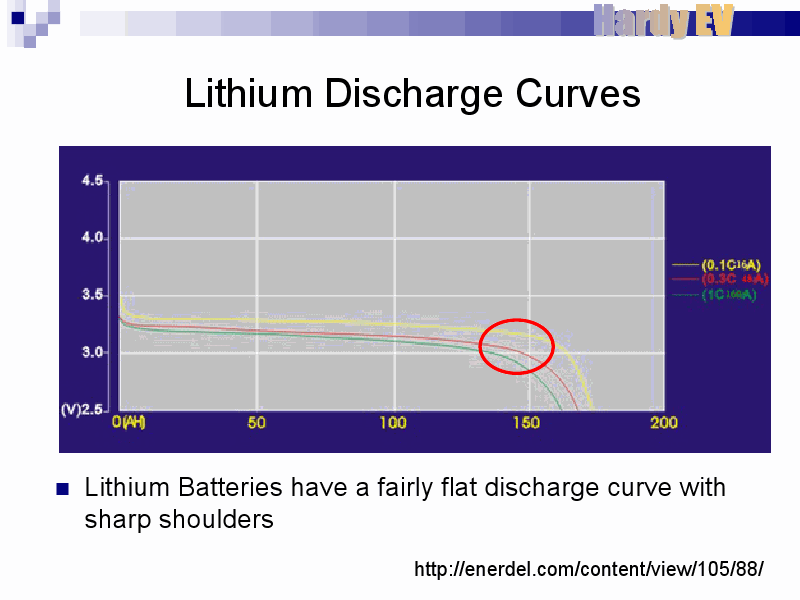

Lithium cells have a flat discharge curve.

Looks like the lithium should be over3V
