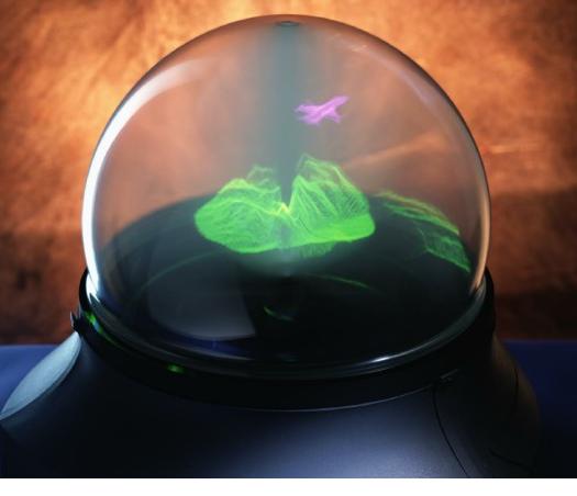

Saw this last year , from Actuality Systems Inc
and is a true 360 degree dispay no less.
Science "fiction" has a knack for becoming fact!

tansis, I seen that too. Still dont know what it does. They should have video's showing off these type of things. Its so hard to believe just by looking at them and words can't explain some of these amazing products.

Yes it does (which is great), but that is a long!!!! way from being a 3d image without a 'screen' - I consider it's 'bowl' a screen really (I'm presuming it's an integral part of it?).
Also the quality is pretty pathetic, it's got a long way to go to make a useable display - assuming the technology employed has the capability of doing so?.
Huge amounts of money have been thrown at the problem of 3d displays for a great many years, I don't believe anyone has managed a practical working version yet.

The actuality one works by persistance of vision, i'm pretty sure. Big rotor spins around with sequenced LEDs on the edge very fast. Only in 3D, not 2D. Like the "floating clock" idea.

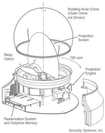

Here is a cutaway drawing of the display from Actuality systems.
(available in the shops now)

I was right!
At least, i think i was right!
Only, i do see one problem with this system (dunno if i'm dumb or what) :
the centre spins slower than the outside. Does anyone see problems with this??

The Actuality 3D display does not trick the eye into building the image in the brain like the "propeller" clock. Basically what you have is a spinning 2D display, for every increment of rotation a slighty different image is displayed.
