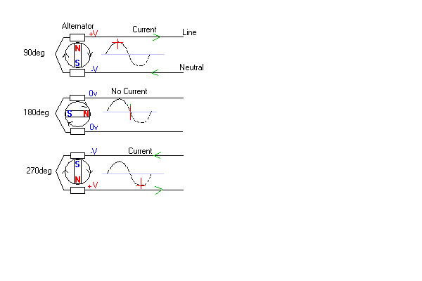

in my home there is tow line can i know what is this
and what is the current flow in the wire is it positive or nigative or ground and what is the charge of ground is it positive
the second question in AC
the signal like signsodial so it is tow wires where is it flow in and the second wires what is have when the first have positice or negatvie

If your house is connected to the local mains power supply and the supply is 'ac' then the two wires are named LINE and NEUTRAL. sometimes the LINE is also called PHASE.
In some countries the NEUTRAL is connected to the EARTH wire.
As the supply is 'ac' this means alternating current. The power station drives the two wires with a 'sine wave' voltage of 50Hz or 60Hz.
Is this what you mean.?
yes it is
but can u explain me what is the tow line and what the voltage derived
and what is the nutral

Technically, it does not matter if you have a ground. VOltage is only relative to other voltages. So as long as Wire A is sinusoidally going above and below Wire B, and wire B is sinudoidally going above and below wire A you have a sinusoidal voltage.
In real life, they connect one of those wires to neutral and is the same voltage as ground (but not the same wire as ground for safety reasons) because WIre A and B could be AC 120V relative to each other, but they could both be 10kV+120V and 10kV-120V relative to ground. Since you are standing on the ground you are at the same voltage as ground/neutral voltage and would get a lighting bolt jumping towards you from the socket if that was the case.

Look at this image, it shows the basic idea of 'ac' generation.
The alternator in the drawing is just a simple pole magnet spinning inside two wire coils.
The output from the coils is a sine wave, so the current flows one way around the two wires for 180 degrees and then reverses and flows the other way for 180 deg and so on.
So the two wires are alternate positive and negative voltage.
Do you follow OK.?
