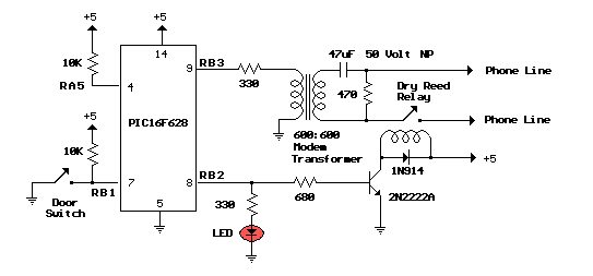

Currently i finished working on my security system project.
The project details are furnished below ...
When a sensor goes ON , the system is activated and the preprogrammed phone number in the microcontroller is dialled with the help of a relay ~ PULSE DIALING SYSTEM.
The micro then produces a steady tone of 300 Hz with the help of a modem transformer for required time as preprogrammed.
The system uses a phone line.
I now want to extend my project such that the Phone number can be entered at any time without preprogramming the micro each and everytime. So i will be using a keypad. A 4x4 must satisfy i believe.
I want the micro to store about 5 - 10 Phone Numbers and dial it consecutively.
I am using a PIC16F628A which has 16 Input / Output Pins.
The person(i mean the owner of the house ) who is gonna install this circuit should be able to enter 5-10 phone numbers using the keypad in the micro and store them and without using using an LCD he can confirm that each number he dials is recognized by the circuit with the help of a LED.
Could someone help me how to proceed further.

split the project into pieces.
1. dial the phone (this is done if I understood you correctly)
2. scan keyboard
3. turn on some led's (to verify the entered number)
4. store data into pic's eeprom
you can find examples of this in Nigel's tutorials:
