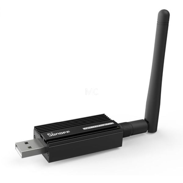

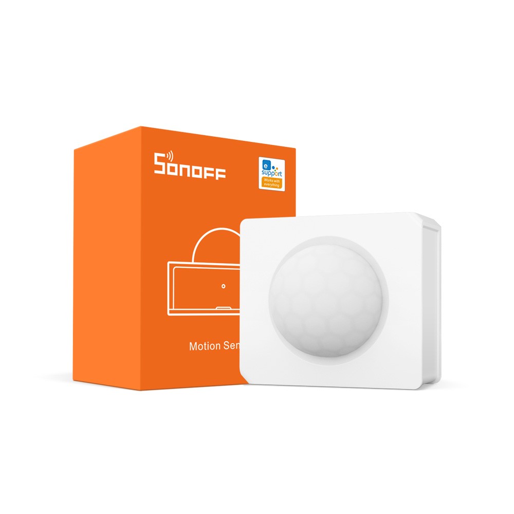

The "Sonoff" zigbee interface and their sensors are very good value, eg.
SONOFF Zigbee 3.0 USB Dongle (ZBDONGLE-E) is a new version of Sonoff's universal Zigbee USB stick. It can be used as a universal Zigbee gateway in Home Assistant, OpenHAB via ZHA or Zigbee2MQTT to locally control all your Zigbee sub-devices, so you don’t need to invest on the Zigbee hubs for...
A tiny little wireless motion sensor with Zigbee connection to an eWeLink Bridge to trigger other devices to turn on/off based on motion alerts.
