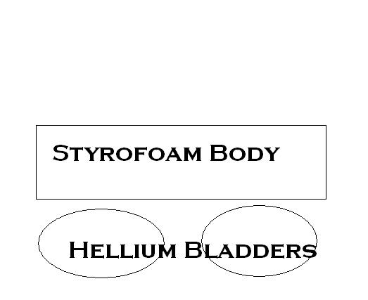

THe fans don't put out enough thrust to lift their own weight (obviously) so that won't work. Better to use helium to lift everything and the fans to move it around.

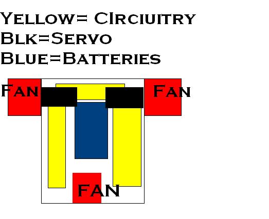

I've already been down this road of modifying a PC fan for any purpose other than cooling, and I hate to be a downer, but it's a fruitless quest. PC fans just can't generate enough useful thrust, and have a poor power-to-mass design.
It's excusable because they're not designed to provide thrust, but to slowly move a volume of air over your computer. If they were more powerful, it'd be like having a vacuum sucking all kinds of bits into your computer (which happens with dust over time anyways).
Even lower thrust applications like a hovercraft or blimp are too much for a PC fan. The blimp might work, but for the hassle for what you would get out of it, you'd be better off going for a motor initially designed for the purpose.
To give you an idea, a PC fan didn't even provide enough thrust to be used for my recorder robot, which requires extremely little thrust.
I'd guess an analogy for thrust to electonics hobbyists would be that to voltage. It doesn't matter if the fan's moving a large volume of air (current), if the thrust (voltage) is low, when the air encounters any kind of resistance (resistance) the air flow (current) will fall to zero.
It's a bummer, because there's obviously a surplus of computer fans all over the place. My advice is to get creative about using them for other cooling applications (i.e. mount one over your high-powered ICs).

Ok i have been thinking of a design :)
I made it in Paint :D
