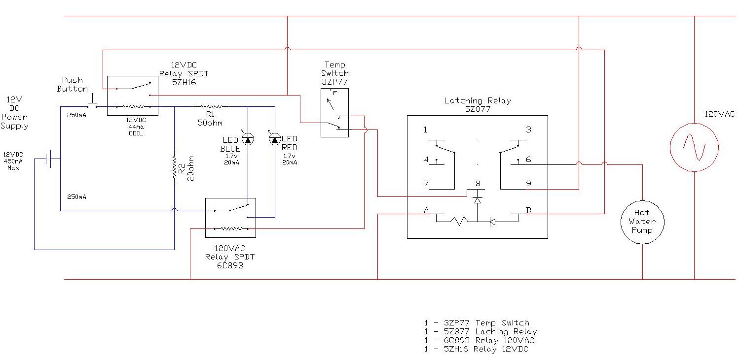

I just purchased a new house and it has a hot water circulation system. I am out in the county using propane. I am trying to restrict utility usage and don’t want the pump running constantly. I can set a timer at certain times of the day but all that does is make my water heater heat up cold water for no reason. Purpose of this circuit is to allow me to push a button in the desired room that i want hot water and after a few min or so be able to get it. On the wall next to the switch would have two indicator lights one blue (cold) and red (hot).
Momentary contact with a latching relay and a temp switch to release the latching relay.
Temp Switch would have a sensor at the recirculation pump to sense temp returning to the water heater.
Does everything look ok? or am i missing something

Haven't gone through your circuit yet, so I'll post again, but my initial impression is that it is overly complicated. I'm wondering if you would accept simplifying by using a fixed time delay instead of waiting for a specific temperature to be reached on the return water. For example, if you used one time delay relay you could really simplify this whole thing. Such relays typically allow you to dial up a fixed ON time up to a couple of minutes. If this is enough time to get your farthest tap's hot water up to temperature, it would be simpler indeed.

I am hip to the option to putting in a time delay relay. They are very reasonable and would simplify the circuit quite a bit.
