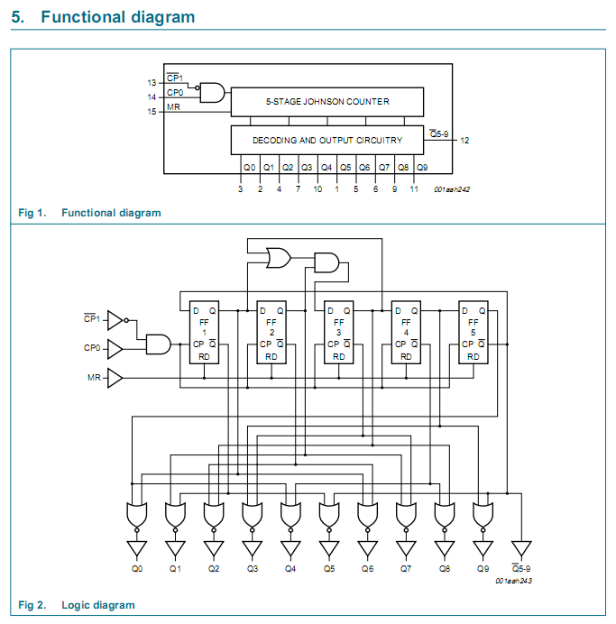

Does any one help to wire the counter IC 4017 to generate the negative pulse output since the input is clock signal.
I had found somewhere on the internet before but forgot, that the clock signal fed into the pin 15 or 13 ... and pin 14 to ground then outputs will produce negative decoded pulse???? correct me if I am wrong.

If Pin8 is at 0V and pin12 is at +V.
The 4017 will produce a high going 'positive' pulse on the decoded output.
Why would you require a 'negative' pulse.?

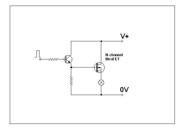

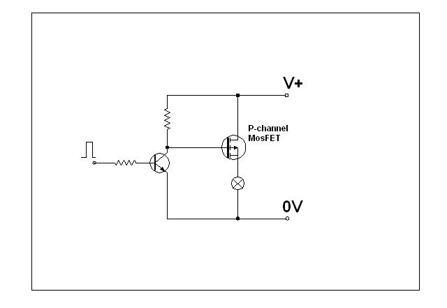

- The state "...inverting the counter output signals" is what you mean if using P-channel mosFET? (attached 1)
- And the attched 2 is that possible idea if using N-channel mosFET?

hi cuus,
I guess when you said 'negative' pulses you really meant low going pulses. ie: from high to low, +V to 0V............?
Look at the CD4049 hex [6] inverting buffer.
You could use a N MOSFET connected to the 4017 outputs, place the load in the Drain of the FET.

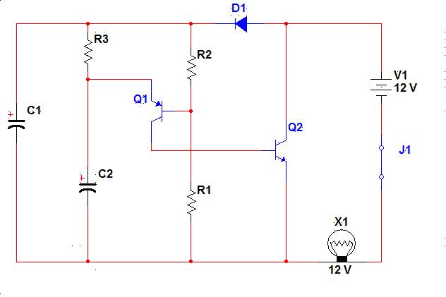

Infact my existing circuit is similar way to drive the power transistor and load feeding by 0V as motocycle electronic flashing unit (attached)
So that's why I need to replace the NPN power transistor Q2 by P-channel mosFET, but somebody advised the N mosFET is better. Power Supply is also 12VDC.

BTW my attached diagram is showing the motorbike turn flashing signal circuit to replace the traditional thermal flashing relay, so that why they hook the ground supply via loads (following the original concept of manufacturer), but as my experiment the circuit did not work well because when Q2 is on, the voltage at Emitter come up nearly with Vdd so cause the oscilation of Q1 is fail to supply and the flashing pace is disorder...
So I wonder if sombody help to solve this problem but keeping the traditional connection or have some good idea to improve it.
