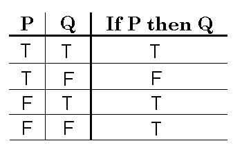

On any logic circuit like this there is a good brute force method for finding a logic circuit.
If you draw up the whole truth table you can then make a logic circuit that ANDs together all the 1's and NOT 0's in the input for each line in the table that give a 1 as the output. You then Or all these little circuits together. A little boolean algebra and you have your final circuit.
an example for the truth table posted:
Line 1: (P AND Q)
Line 2: nothing because it outputs a F
Line 3: ((NOT P) AND Q)
Line 4: ((NOT P) AND (NOT Q))
Now OR them all together:
(P AND Q) OR ((NOT P) AND Q) OR ((NOT P) AND (NOT Q))
This is a valid circuit but you need to use Boolean algebra to simplify it.
