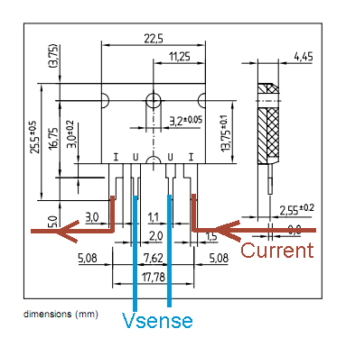

Here is the data sheet of the ISA-PLAN type PBV resistors. It doesn't contain any wiring diagram as well.
It's pins are labeled 2XI and 2XU. That's all I can find.

hi Hans,
I have marked up your resistor pdf, you should use the blue wires for the MCU voltage sense take off point.

To measure low resistance, you need to measure the current through the device and the voltage across it. Note the the terminals are labeled V and I. The resistance is guaranteed between the two V terminals. Hence, you passthe current being measured through the I terminals and measure V across the resistor across the V terminals. The V&I next to each other have the same sign.
Thanks for your input.
I will buy that awefully expensive resistor (with heatsink EURO12) and check out its accuracy with the "V" terminals connected.
