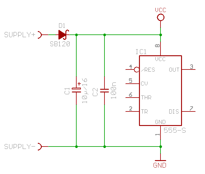

It is obvious and very clear: An IC connected to the supply source reversely burns up immediately, no matter how long it is connected.
Connect a protection diode (or two) in front of your circuit for the power supply.
Use a Schottky diode (for least voltage drop) rated for the current of your circuit.
