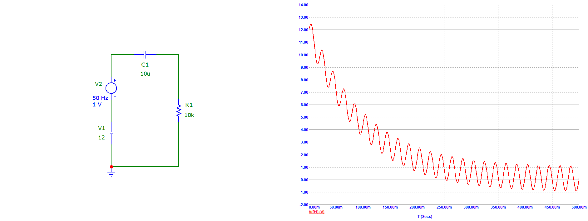

I have this test circuit, which has this signal:
V1 may change from 1 to 30 V, V2 may change from 0 to 4 V peak to peak.

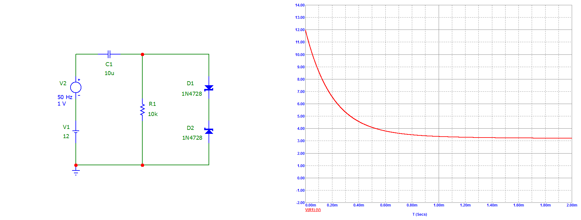

So I added two zener diodes and the signal was clipped:

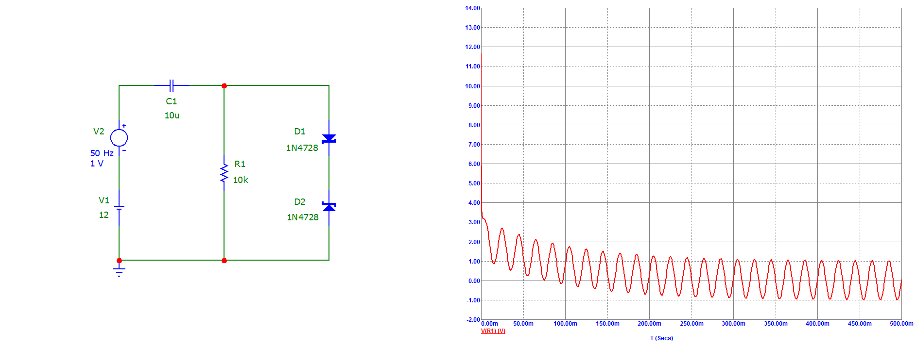

But it was not fast enough, for about 300 microseconds the signal was still above 5 V - the Op Amp power supply voltage, which, I figure, may damage the Op Amp:
How can I clip the voltage faster, without distorting the signal that is below 3 - 4 volts?
Add a resistor in series with the capacitor, somewhere around 100 Ohms to 1K.
That should limit the current through the zeners and allow them to regulate the voltage better.
Thank you, rjenkinsgb! That does work. Although at higher resistance it attenuates the signal, so it is going to be a bit of a trade-off.
If you put a resistor in series with the op amp input (e.g. 10kΩ) with two small Schottky diodes, one from the input to the V+ supply (cathode), and one from the input to the V- supply (anode), the op amp should be protected from any input overvoltage without affecting the signal amplitude below that..
Thank you, crutschow, that does help.

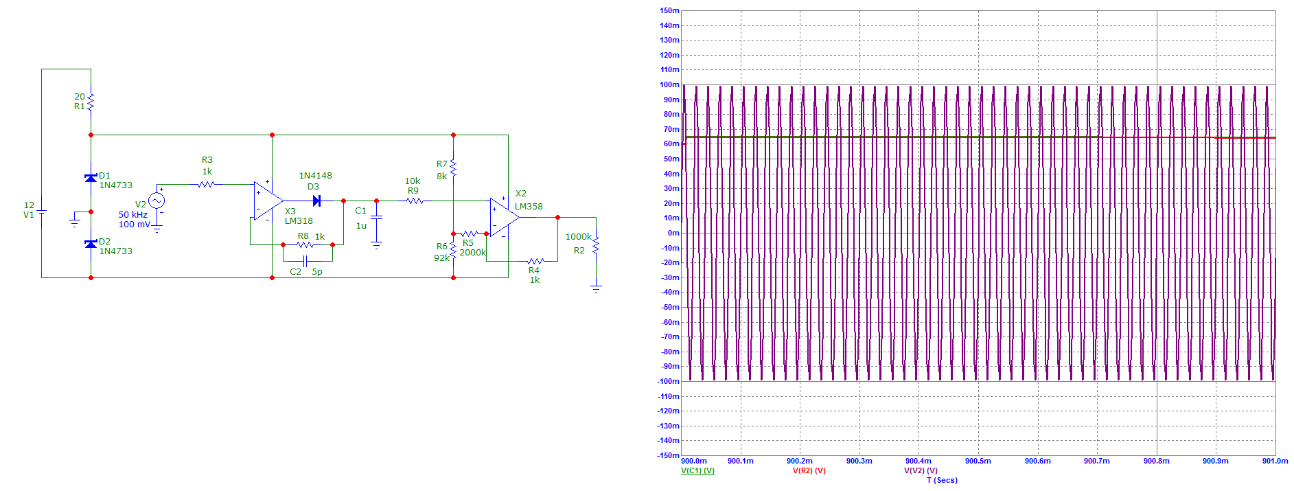

Unfortunately, now I ran into another problem, and I am stuck figuring out if my project is feasible at all. Maybe it is not. I was thinking about making a peak detector that was supposed to work from 20 Hz to 1 MHz. Now it works well at low frequencies, but I see a significant signal attenuation already at 50 kHz.
I do not understand why it happens, because both the diode and the Op Amp should perform well at 1 MHz. I am reading a textbook on Op Amps now, but maybe this project is not doable at all. Thanks for the help, guys, anyway, those were good lessons for me.
