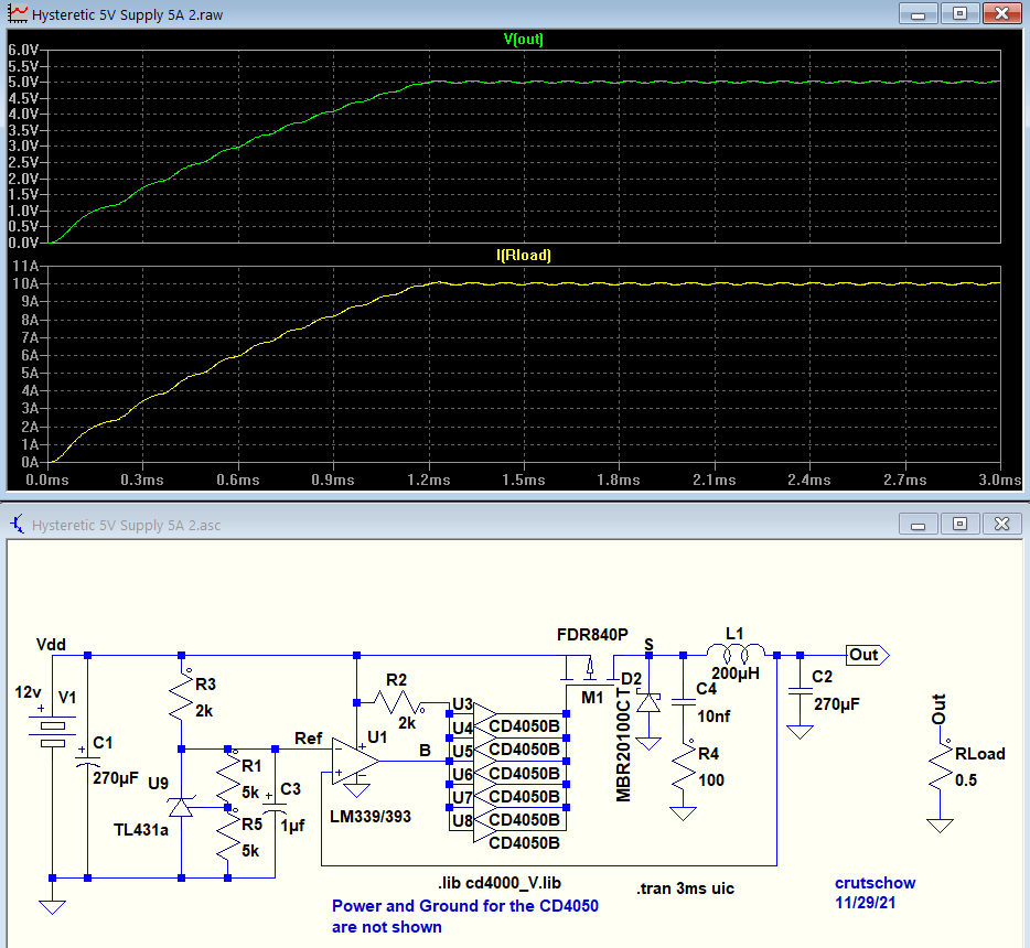

Hi, I have a project which is creating a step down converter that takes 12V and gives 5 volts. It is required to handle 10 Amps which is I think a bit overkill. Anyway since they don't teach us anything in Electronic classes other than stupid imaginary sinusoids most of my teammates doesn't know how to make a circuit. So I tried to create a simple oscillator with everyone's favourite 555 IC and gave the square wave output to the npn transistor. I need to implement some sort of feed-back to this circuit so voltage doesn't drop under heavier loads. I think I need a comparator to detect when voltage goes below 5V and increase the Duty cycle or frequency but since it is fixed by the resistors R1, R2 and the capacitor I don't know how I can change those. I don't want to use any special buck converter IC's for this circuit and keep it easy enough to explain to someone who doesn't know much about this sort of stuff. What can be done can someone explain.

Below is the LTspice simulation of a simple hysteretic converter:
It uses an LM339/393 comparator, and six CD4050 buffers (one package) to act as a driver for the large gate capacitance of the P-MOSFET.
(A MOSFET gate driver IC can be used in place of the CD4050).
A TL431 programmable 2.5V reference is used to set the output voltage at 5V.
C3 provides a slow (soft) start to minimize any output voltage overshoot during startup (otherwise the output would go to about 10V).
It has about 70mVpp ripple with a 10A load, which should be acceptable for most digital circuit requirements.
Note that the inductor must be able to handle at least 10A without saturating.

Simple hysteretic converters don't have an "oscillator" (see post #2).
Their switching frequency is determined by any hysteresis in the switching voltage and the output LC time-constant.
It turns the switch on when the output ripple voltage drops below the reference voltage, and turns the switch off when it goes above the reference voltage.
(See below, showing the MOSFET control voltage (red trace, low is ON) versus the differential voltage at the comparator input.)
In your version there is not a error amp
Hysteretic converters don't have (or need) an "error amp" as such, they use a comparator in a "bang-bang" configuration.
They have the advantage of being inherently stable and not requiring any frequency compensation of the feedback loop.

Can I use IRFP260 mosfet for this. I have appropriate mosfet driver for it from a failed tesla coil project, if I am not wrong it should be capable of switching very fast and has high power ratings. And soldering it would be easier because of its package.
Nope.
That's an N-Channel MOSFET.
My circuit needs a P-Channel MOSFET.
They are not interchangeable.

Typed wrong. I was wanting to say there is not a real error amplifier.
True, there is not an analog error amplifier (since it doesn't need one).
But I will argue that the comparator is a error amplifier since it senses the voltage difference between the reference voltage and the output voltage.
