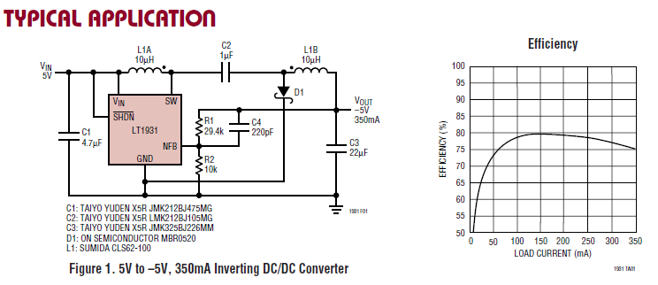

Hi all,
i need to generate -5V switching voltage from +5V input voltage so can anyone suggest me some circuit to achieve this.
Thanks & Regards,
Manjunath
How much current?
This one is only good for 300mA but shows what needs done. There are examples in the data sheet for +5 to -5.
Also see LM2611

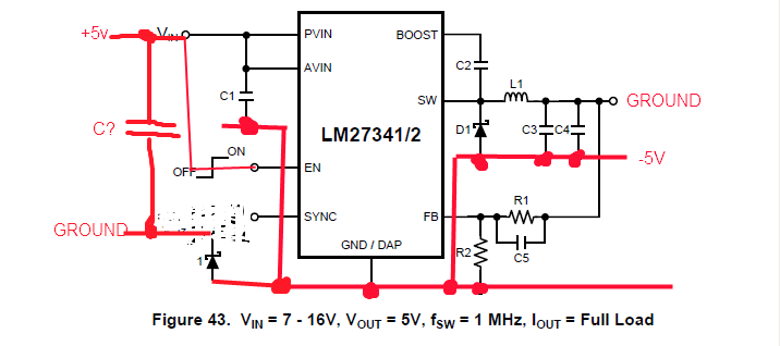

From the data sheet BUT:
This circuit was designed to operate as shown in black below. I changed it. See the output goes to ground. And GND is now -5V (the new output) As it tries to lift ground it will push -5V down. The FB pin looks at (-5V and GROUND) and will stop when the output is -5V.
