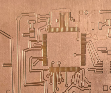

how can i improve the milling of small pad especially for MCU like stm32750vbt6
for example on this am using a spiral carbide engraving bit of 0.1mm 10 degree but some pad are well done but other copper are being removed how can i collect them
That is very ambitious for a milled circuit board. You need a very fine bit. The height varies. The bottom left of the square IC is too deep and the top right is too shallow. There are devices that you can use on engravers to keep the depth constant, which might help.

View attachment 147495for example on this am using a spiral carbide engraving bit of 0.1mm 10 degree but some pad are well done but other copper are being removed how can i collect them
You'll need one or more of the following...
- a better quality (flatter) board
- a better way to clamp the board to avoid cupping/bending of the board from flat
- a vacuum table that is extremely flat
- a gantry for your cnc with straight rails and essentially no flexing.
- no up/down movement of your shaft in the quill
Flatness over a large area is pretty difficult for a multilayer organic/inorganic multilayer. Any stress in the materials during fabrication of copper foil, epoxy resin, fiberglass mat, epoxy, fiberglass mat, epoxy, copper foil - your board will twist/warp with temperature changes (and it does and it may not even be flat from the beginning). If you have a single-sided copper board, you'll get even more warpage and unevenness.
Remember, you're only removing about 35 micrometers of copper so flatness must be better than the depth you are penetrating the epoxy resin below the copper.
Flatter board is partially taken care of by running probing correction routine, leveling,
and using that data to correct mill G Code. But as ZZO states problem has
additional problems not solved just by leveling code.
