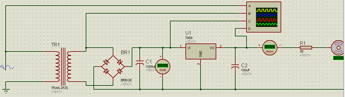

hi everyone,
i have to make an 9volt 300ma dc adapter.
i made it but i can not obtain 300 ma. i need help to obtain 300 ma.
my circuit is here.
i used
a transformer
bridge rectifier
a 1 uf capacitor
l7809
a 100 uf capacitor and 30 ohm resistance
do you have another idea ?
thanks a lot.

What exactly is TR1 the transformer? Primary (mains) voltage? Secondary voltage? Current capability?
Ron
I assume that the transformer is at least 10VAC/0.5A so that the input to the 9V regulator is at least 11V.
If 300mA flows through the 30 ohm resistor then the output from the resistor will be only 0V.
Why do you use the 30 ohm resistor to waste the entire 9V? The 30 ohm resistor is simply a 2.7W heater.
What is the load? A DC motor?
thanks a lot.
load is resistance.
primary voltage is 220v secondary is 12 v capability is 3 w or 6 w
3 W will give you about 250 mA max and 6 W will give you about 500 mA max. So if you have a transformer capable of 12 VAC @ 500 mA the 9 volt 7809 regulator should work fine.

Something that wasn't mentioned was to make sure you use a heatsink for the regulator .....
Taking a 12 volt AC, rectifying it to DC with a full wave bridge will give you 16.92 volts. Dropping this to 9 volts at 300ma will mean you need to dissipate around 2.4 watts of power as heat. It may not seem a lot but things can soon start to get hot !
