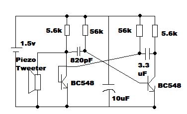

Will this work? Thanks. Dug it out of a old book.
That's a very standard circuit - but I'm not sure why you've got such a large difference in the value of the capacitors (820p and 3.3u). They should be equal (for 50% duty cycle).

Just one last question.The circuit provided by dreamie works at what frequency?I think that a frequency of about 20kHz and above is required to repel mosquitos.Will that work?Does anybody have a different idea or improvement for that circuit?
