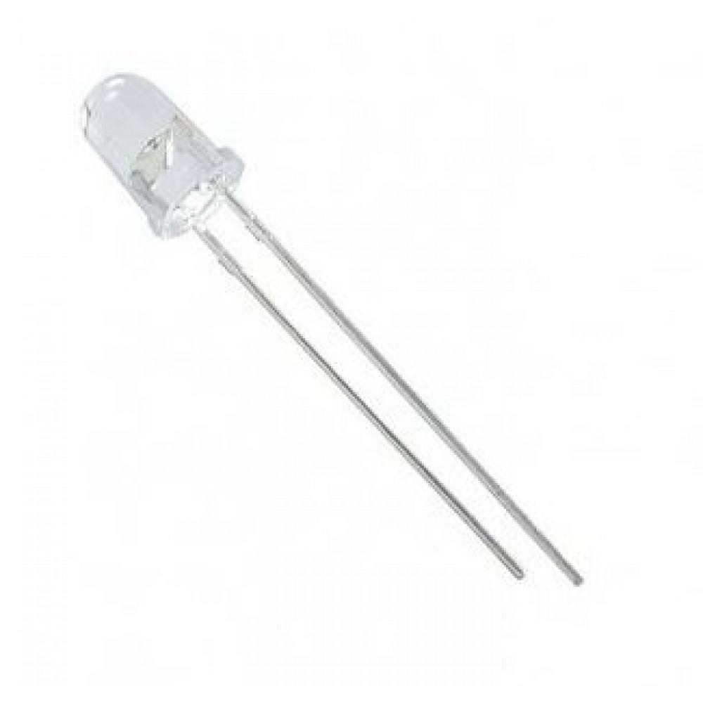

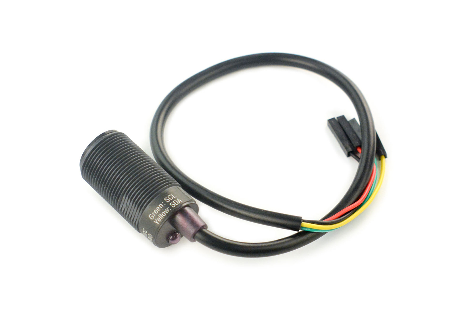

I am working on an Arduino project where I use an infra red camera that measures distance along with 4 infra red LED transmitters placed each on a corner of a square platform to park a robot perfectly on this platform. However, it is important for the camera to distinguish between the 4 transmitters. (it should know the right transmitters from the left and the upper transmitters from the lower). Can anyone please help me find a solution to this problem?

Why not?, IR LED's are very commonly pulsed.
What do you mean by they are 'transmitters'?.
this is the link for the camera i'm using along with the Arduino code.
and this is a picture of the led transmitters i'm using

Your camera "keeps track of 1-4 objects". I think you are using the software that does that. When you blink a LED the software will loose track of that LED. So there is much of the problem. I think you have software written for a different project and you can't get around that.

I had control of the light source. I could turn on/off change color of any point. If you can not directly drive the light, then you must have the LEDs blink in some pattern and then synchronize the software to the pattern. This will slow down the process.

Exactly, thank you.
