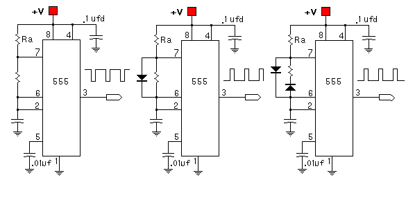

You have to think of a way to get the timing capacitor to charge and discharge through the same resistance to get 50% duty cycle. It's on Google somewhere...if I remember right it involved using bypass diodes so the charge and discharge current only flows through certain resistors which means you can choose the discharge and charge resistance independently of each other (rather than just Ra+Rb on charge and Rb on discharge which means the resistances will always be different).

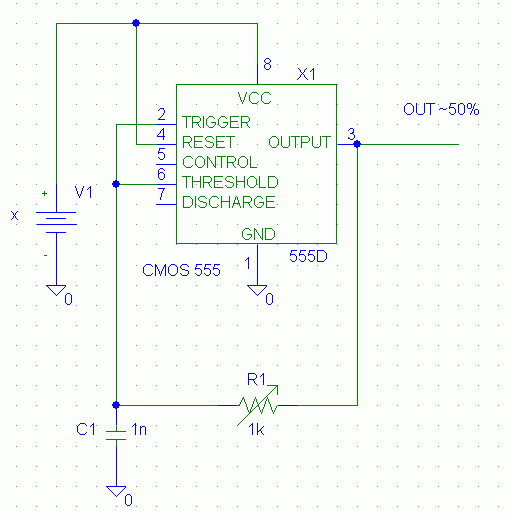

Just run one resistor from pin 3 output to the cap, and don't connect discharge pin 7. You will get 50:50 duty cycle if it is a CMOS 555, almost 50:50 for the olf TTL version.
Replace the resistor with a pot and you get a wide frequency range but always with 50:50 duty.

See attached schem (ignore component values). The duty cycle should stay constant over the frequency range. You may want to put a series resistor inline with the pot.

if you're operating the IC in astable mode, attach a diode in parallel across the resistor b/w pin 4 & pin 7. The purpose of the diode is to bypass this resistor during charging so that charging occurs only through R76 instead of R47 + R76. Acc to the pricnciple of operation of IC555 as soon as control voltage is reached the capacitor will discharge through R76 only till threshold level. Now if charging & discharging is ocuring through the same effective resistance, Duty Cycle will be 50%
Ton = 0.693(R47+R76)C but R47 is bypassed for any positive going signals and hence effectively, Ton = 0.693(R76)C = Toff.
There's your 50% duty cycle

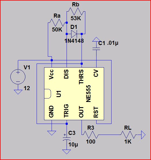

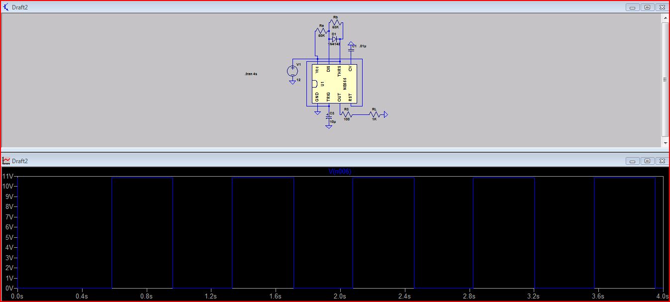

If you place a diode D1 in parallel with resistor Rb between 6 and 7, adjust the value of Rb to match the series resistance across Ra (between Vcc and 7) and D1.
For example, instead of using 50K for both Ra and Rb, I got a more even duty cycle using a 53K resistor for Rb.
