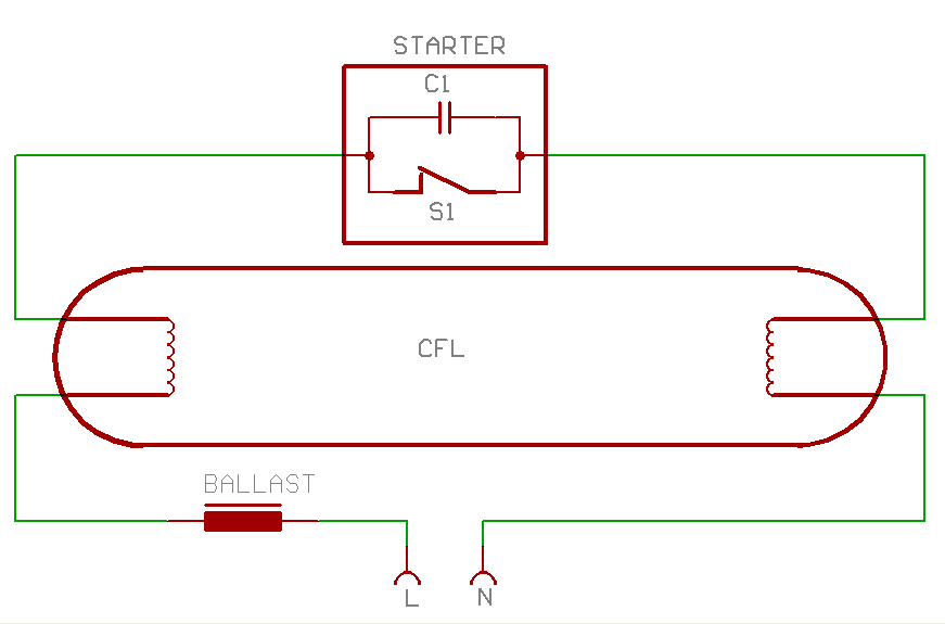

Hi Paul,
Ron brought this threat to my attention.
CFLs are wired the old fashioned way in Thailand with a ballast having one input and one output wire. The ballast is wired in series with both filaments in the CFL via the starter.
Connecting a filament type lamp instead of a CFL it should be connected to (switched) L and N, ignoring ballast and starter completely.
Starters are built for a certain power and if left in the circuit it could burn up if the filament type lamp's power exceeds the rated power for the starter.
Instead of experimenting with the wires I suggest to call a local electrician to change the wiring. They generally know how they connected the original wiring (completely different from European standards and twisted wires instead of connectors, isolated with tape :) )
A "Chang Faii Faa" will cost you about 50Thai Baht per hour.
When the Chang has finished his work perform intense testing of his "magic work". My Chang managed to convert a CFL circuit into a randomly flashing filament type circuit. :D
(He forgot to jump (bridge) the starter.)
The image shows how CFLs are wired in Thailand.
Regards
Hans

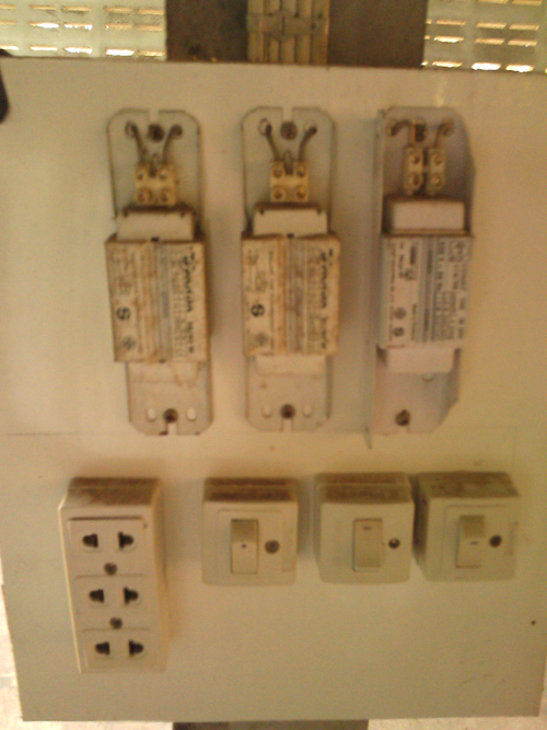

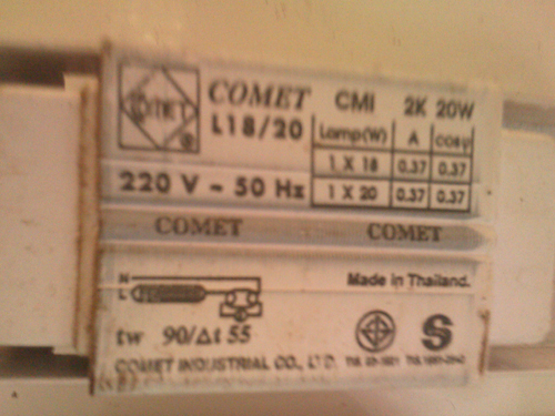

Thanks to all for the added posts. Hi again, Hans! :- ) I understand that you suggest I contact an electrician, and I certainly will because I need some other things done like installing the water heater and probably a new water pump, too.
That said, ha! Your diagram seems to confirm that the two wires I see going into this box are indeed just one interrupted wire. By the way, phonephotos are below.
So, I should be able to just:
1) TURN THE HOUSE POWER OFF.
2) DOUBLE-CHECK THAT IT'S OFF.
3) Unscrew and pull those two wires out and carefully join them securely
4) Turn the house power back on.
5) Problem solved.
Right?
-Paul

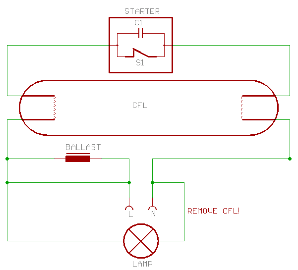

Hi Paul,
problem solved halfway.
You don't only have to jump the ballast by removing it from the circuit, but also the starter.
Just go by the schematic I posted earlier. Not jumping the starter you'll have that fancy randomly flashing light bulb as I experienced. :)
Connect the lamp as shown in the schematic diagram.
Regards
Hans

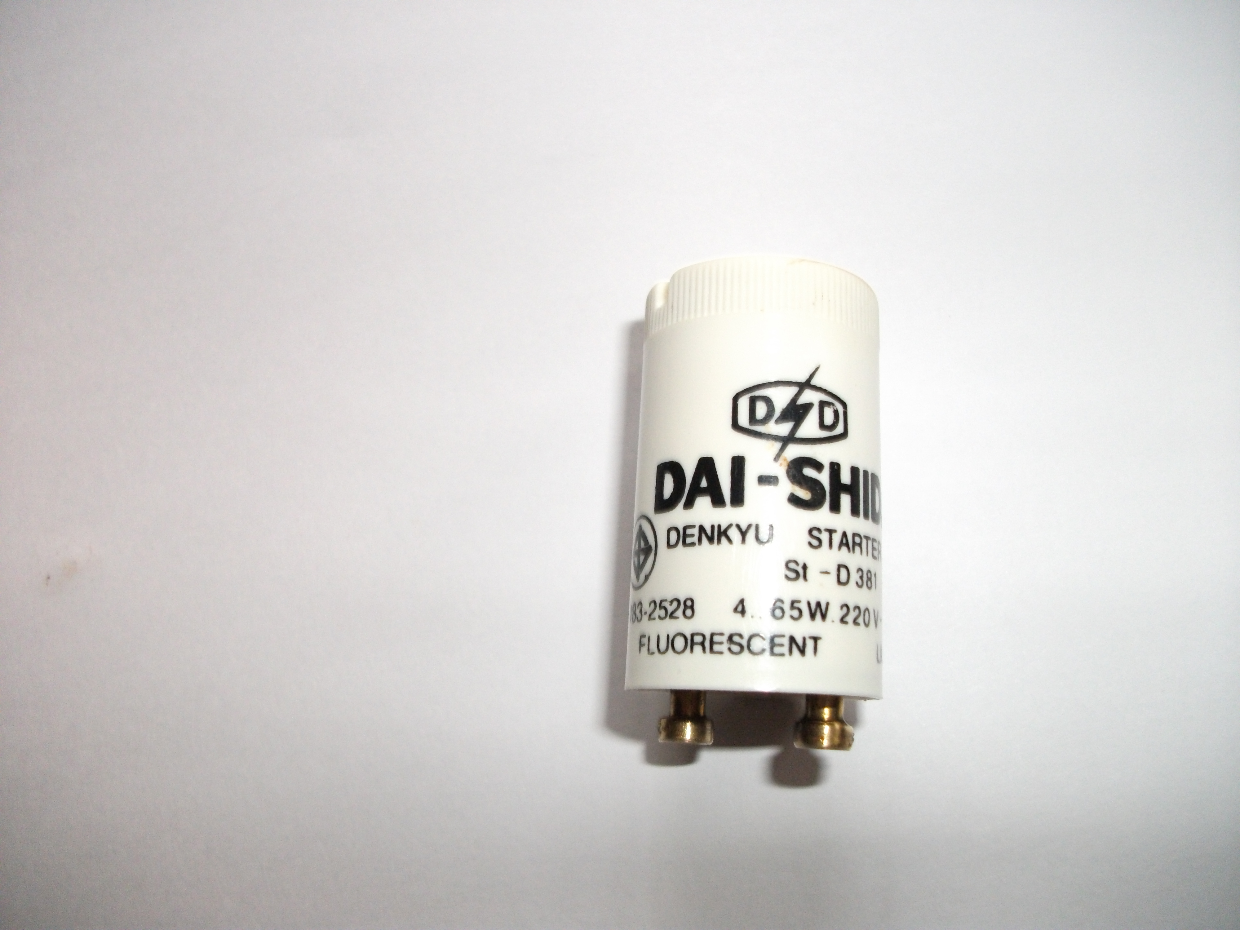

That's a starter.
You don't need it for a filament type lamp.
Ok, thanks! Happily I don't think I have a starter around anymore. Maybe it was indeed attached to the fixture, now thrown away.
-Paul
If your fluorescent lamps start flicker free they don't have a mechanical starter as shown, but an electronic circuit instead.
It's normally built in one of the sockets for the lamp. The glass tubes of those lamps have a diameter of 1".
