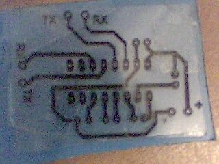

I bought blue color pcb. Seller told you will use normal paper. After print your pcb scheme you will put on it and under the lamp will pass to blue surface. And you will put the acid and ready. He gave me less information.
Later i searched at internet i found only one web page. here:
DIY Printed Circuit Board Using Photo Etching Method | YourITronics
I dont have uv lamp. Will i take out the blue surface? Can i use normal lamp. Somebody used of this kind of pcb? If yes can you give me more explanations?
Thanks.

i coudnt success. I bought UV florecent lamp. I printed on transparent paper. i put on my blue pcb part. It stayed onder the uv light around 40 min. not progressing. I am sending foto how i did. Help plssss.

Dear Ser!
What is "blue PCB", You have.
I suppose, it is pcb with photo-resist coating, with blue self-adhesive protecting
plastic sheet over."Bungard" is manufacturer of such boards, and I use lot of them.
Before You make exposure to UV light, You must pell-off protective blue sheet.
For exposing, you may use "black-light" lamp. (fluroscent lamp as for
fake monney detection devices).It is long-wave UV light, but ideal for photo resist,
and not harmfull fo eys.I use 3 x 8W on distance 100mm, and 4 Hours exposure.
All is critical, exposure, developing and etching.You must experimenting.
I cut narrow piece of PCB material, and expose (hiding with opaque material),
for 5, 10, 15, 20, minutes, develop and etch, to see results.
NaOH solution is used for developing, but special developer is better,
and safer in any way.
T.D.

Are you sure about 4 hours of exposure time? I normally use 6 X 15W at about the same distance with a maximum exposure time of 240 seconds (4 minutes).
Bungard photoresist PCB material is pretty consistent and I didn't experience great differences concerning exposure time.
The quality of the PCB depends not only on exposure time, but a great deal on the material used to create the PCB. Even semitransparent carriers make exposure time unpredictable.
A positive transparent film can be made using the semitransparent carrier for a contact copy. Develop and fix the positive film which will be fully transparent and deep black for traces, pads and vias.
Boncuk

Did you develop the PCB?
