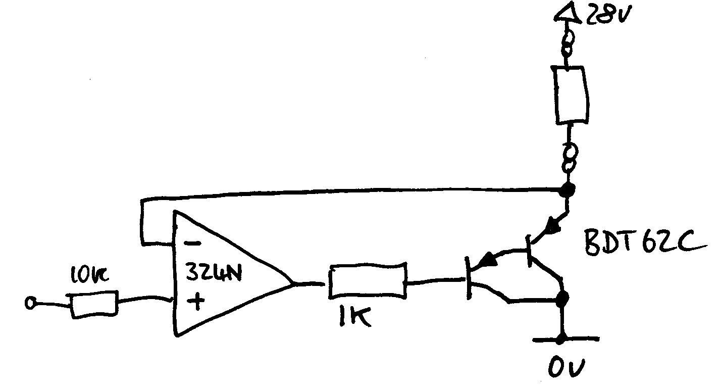

I'm really struggling with something as simple (?) as a current-boosted voltage follower.
Putting a supply-tied transistor or FET into the feedback loop of a unity gain op amp works well every time, but I can't seem to manage to devise a circuit that works with the current-boosting FET tied to 0V.
It is essential that the circuit sinks rather than sources current and that the load is tied to supply and I only have a single 0V/28V DC supply to power the op amp.
I'm missing something here I know - I thought it was that the feedback was of the wrong polarity, and tried to remedy this by inverting the feedback (see 3rd circuit). Now I'm just floored!
Can anyone show me the light please?

Your first circuit should work with C1 to control the oscillation. If you reduce the value of C1 you should be able to find a value the eliminates the oscillation without degrading the waveform.
You could use a PNP transitor as an emitter follower (emitter connected to the load). That would allow the output to go to about 0.7V above ground minimum without a negative supply, if that's acceptable.

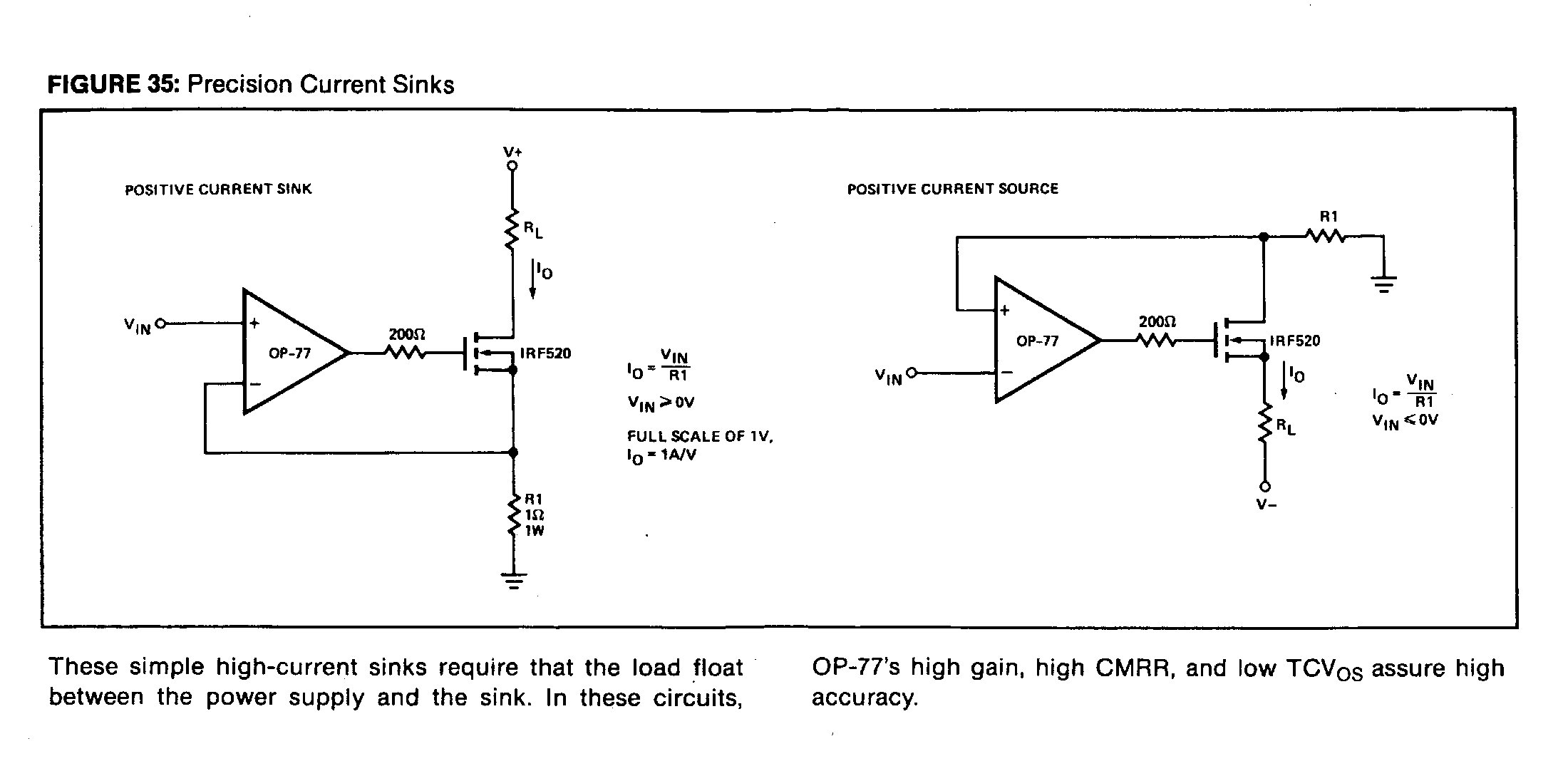

If you are trying to modulate the current, you need a voltage-controlled current sink, not a voltage follower.

Crutschow - you hit it on the head.... working circuit attached. I used a BDT62C PNP darlington in your suggested configuration and it's good for a 1.6A load.

Roff - Maximum drain will be around 2.5A. I looked up the attached current sink (voltage controlled) and built it. It's dreadful - the feedback voltage is load dependent - I don't understand it. The load is current-limited all by itself so I'm staying in the voltage domain!!

The output of your BDT62C circuit (it is not a current sink) should follow the input voltage from 2V to 26V perfectly. If the output tries to have a reduced output voltage then the gain of the opamp (100,000 at DC and at very low frequencies) reduces the error so that you won't notice it.
The OP-77 plus Mosfet current sink circuit provides an output current controlled by the input voltage. Its output voltage changes when the load changes to keep the current constant.
The lousy old LM324 has trouble at frequencies above 2kHz so maybe the frequency is your problem. The MC34071 opamp works well up to 100kHz.
