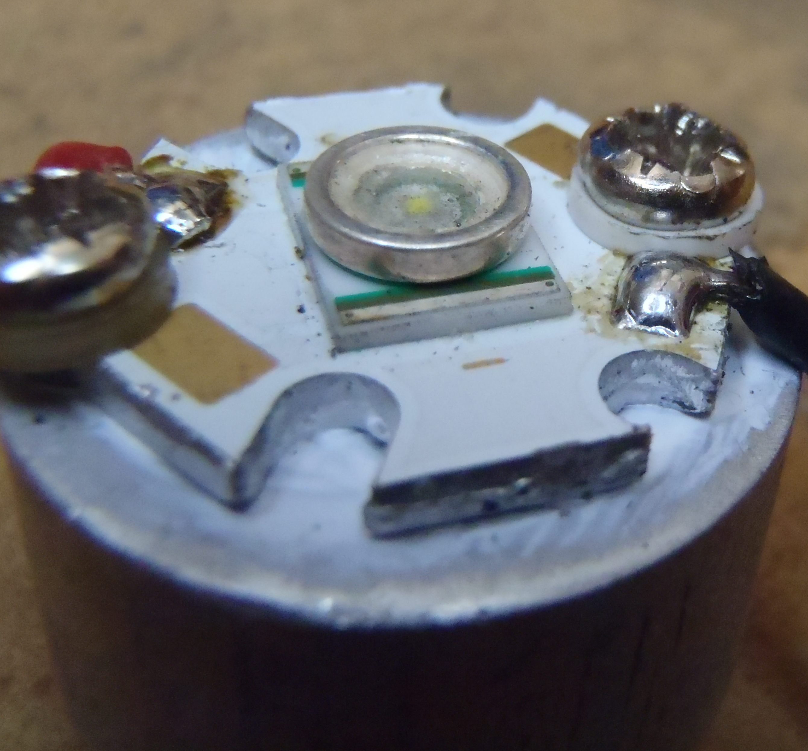

Ive got some LEDs I want to mount on a strip of aluminum to act as a heat sink, and mounting bracket.
However, Im unsure how would be the best way, and best materials to use to mount.
I searched Google images and didnt find anything..
Thanks,
Andrew
Hi

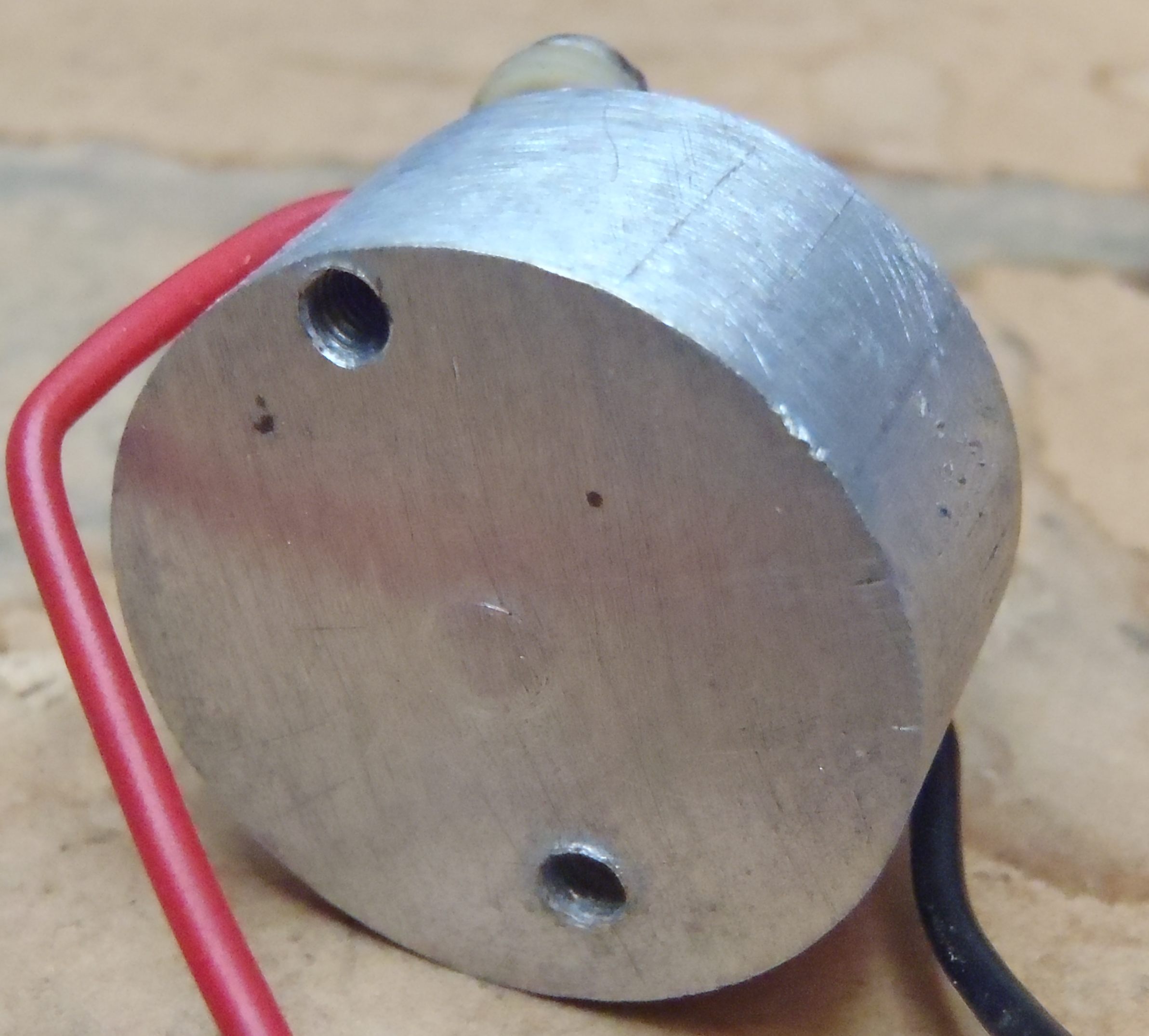

I got my heat sink, a chunk of Aluminium, machined it up into a nice disc, then drilled and tapped some holes that matched the LED's cut outs.
I had to use insulating washers as the screws would have shorted out the contacts.
I have taken some pictures for you to show what I mean.
If you don't have access to taps ect, you could alternatively use small (M3) nuts and bolts to attach it. Just make sure it is as tight as possible and that you use heat sink gunk.
By the way, if you can solder the wires onto the led before attaching it to the heat sink you should as this will make soldering a million times easier.

Thank you Tom, I have some M3 screws... and a few insulated washers. Ill swing by the hardware store and see if I can find just the 1 tap, Ive got a set of SAE taps but no metric.

You don't need to get the taps if your bolts are long enough. However, in the end if you tap it, it does look nice!!
