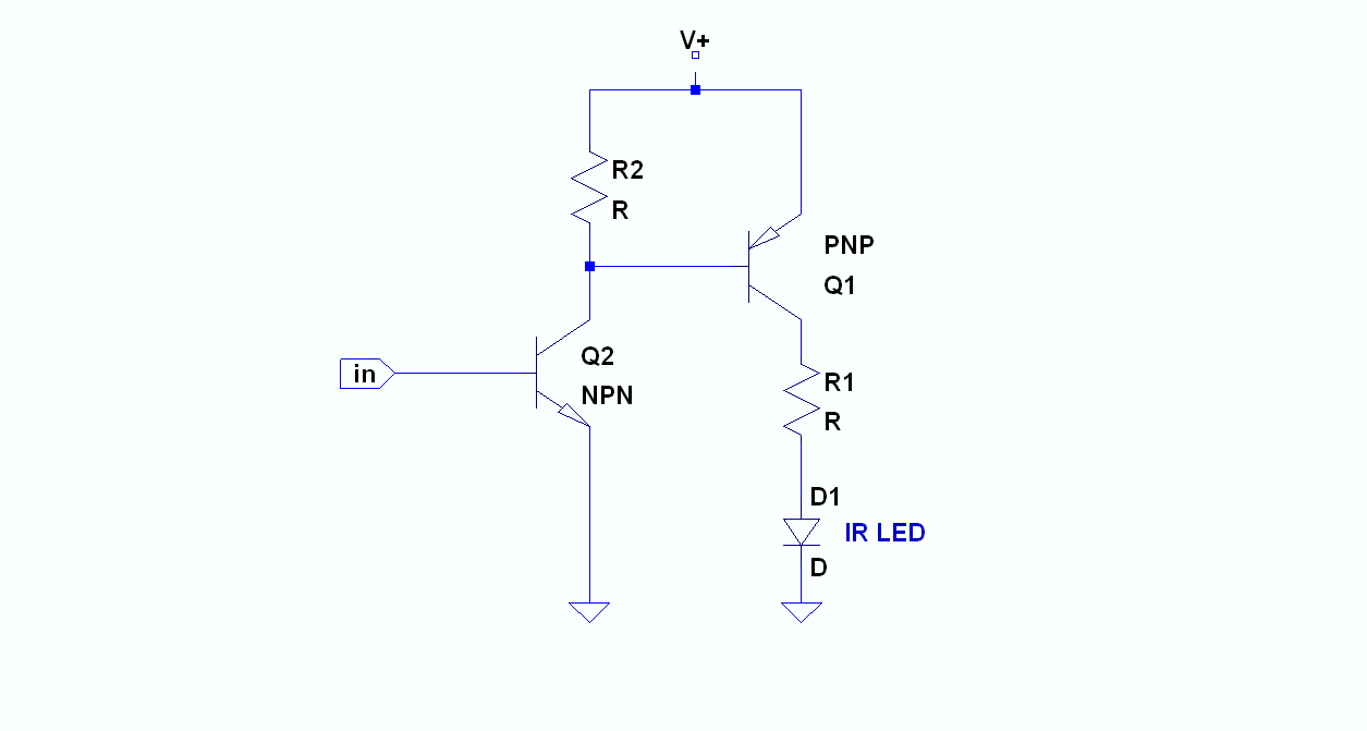

Without performing an actual circuit simulation it is difficult to make specific suggestions.
In general, a PNP type transistor is used as a 'source', while NPN type transistors 'sink' current from a load.
Along this line, you could set up a PNP transistor to supply current to your IR LED. Then devise some way to get the output pin to drive the PNP transistor gate at a sufficient level.
Are you are able to draw a sketch or provide a schematic of your problem .... to clarify the situation?
Here is one possible solution ...

It will be nice to know more. 0.11mA is very small, you should get more like 11mA. Is there a pull up resistor on this pin? (47k)?
If the two NPN transistors are in a Darlington configuration then 0.1 mA into the base of the first should easily get you 500mA from the collector of the second. But there's clearly something wrong if the pin can only provide 0.1mA. You need to resolve that issue first.
Thanks, the Darlington configuration was what I needed. I am now able to get 500 mA out of the circuit.
