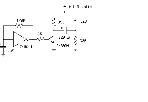

i saw a circuit diagram for a 1.5v LED flasher.. it has a 74hc14 connected in this way.. how do i connect the pins?

The 1uF cap goes to pin #1 and 1K to pin #2
There are 6 gates in the 74HC14
In 1, out 2
In 3, out 4
In 5, out 6
In 13, out 12
In 11, out 10
In 9, out 8
EDITED: The logic supply +V, is connected to pin 14 and the logic 0V/Common to pin 7

thanks... does it means i need to supply the ic with at least 2v so that it works? without it, the ic wont work huh? damn... i wanted to make a small 1.5v button battery LED flasher.. anyway thanks.. appreciate all the help..

The HC range of ic's work from a supply voltage from +2V thru +6v
Your LED forward voltage drop if its a RED led, can be 1.5V or 2v typical, it depends upon the type.
The LED requires a current of about 10 to 20mA.
Get the discharge data curves for a button cell from the web.
I have some circuits with 74HC14 ICs working with a supply voltage of 1.25V and they might work with a lower supply voltage.
Your circuit nearly doubles the supply voltage to blink the LED.
Exactly! Others may read about it here: **broken link removed**
Scroll down a bit for 1.5V Flasher Circuits
A button battery cell doesn't have much current or capacity. It will power the circuit to blink the LED dimly for a short time.
