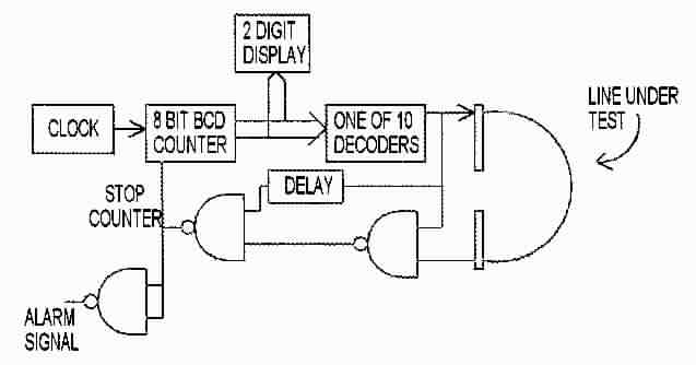

A microprocessor could remember which lines were in error and print out a report. For a quick and dirty solution, this may be an approach:
After the test tech has written down the error number, the counter should be restarted. I have not figured out how to do that, but it should be simple.

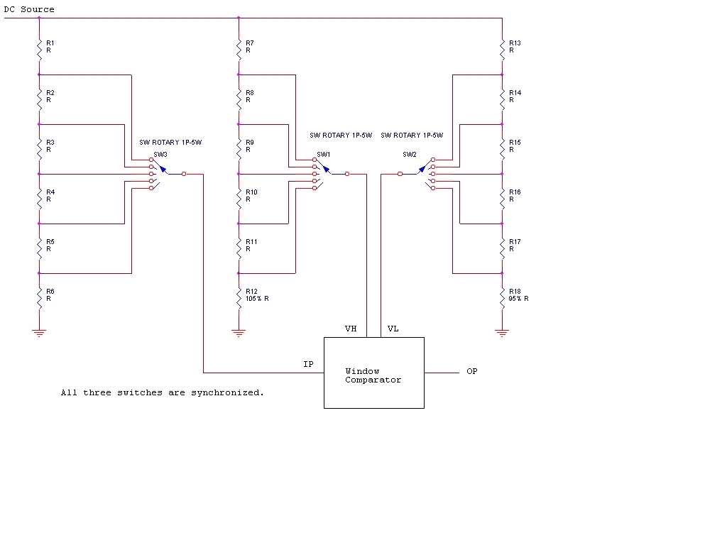

Here is a conceptual method for doing what you want. I have shown five cables, but, of course, you can expand to 25 as you wish. In the diagram, all switches are synchronized, and all resistors are precision 1% or better.
Note that a window comparator is proposed in order to sweep all resistor tolerances. Note that the lowest resistor is each leg of the window comparator is 105%, and 95% R respectively. You choose what R is going to be.
Now, as Russ has proposed, if you could use a uC (easily an Atmel 2313!!!), and a DAC (12 bit DACs are very commonly available, and not expensive), you can easily use the micro to get rid of the two banks of switches and the window comparator. In this case, choose the resistor values to give you voltages that are, say, 10 counts or more apart on the LHS of the cable. The use the micro to "shade" the DAC output +/- 3 counts from nominal. Use the internal comparator to detect in you get a match within this "shaded" region. With this you can determine correct one to one connection, or cross connection, or even open (no connection).
Hope that helps,
Jem
Forgot to mention that the cables are the horizontal segments connected to R1, R2, R3 etc., and the switches are just concepts. You could use analog MUXes, and perform automatic scans.
Jem

A problem with checking the continuity of each cable segment in turn is that it is unable to detect shorted pairs. If that cannot occur, then it is indeed simpler.
Jem
