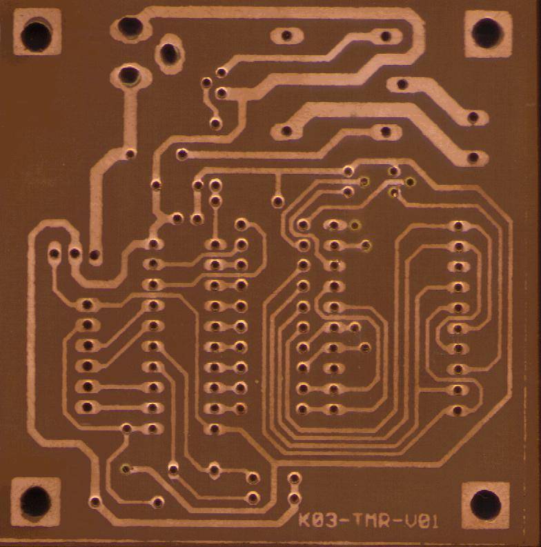

Hi bogdanfirst, I am attaching a sample of my creativity :lol: Just have a look. Would be glad to hear your review :)
thats marvelous.
did u do all that with an hand electric drill ?
it looks SUPER!
i just wish mine would look like that.
but what do you use to draw them with? do u use a ruler?
please give me some tips, i really need !!!
i dont think that the drills are the poblem, how did you draw it? with your hand? i dont think so...please give me some details, i seem to be very oldfashioned
kinjal once said he used transfer sheets (dont know the exact term).
guess u take a laser printout on a screen thing and transfer the image to the pcb.
