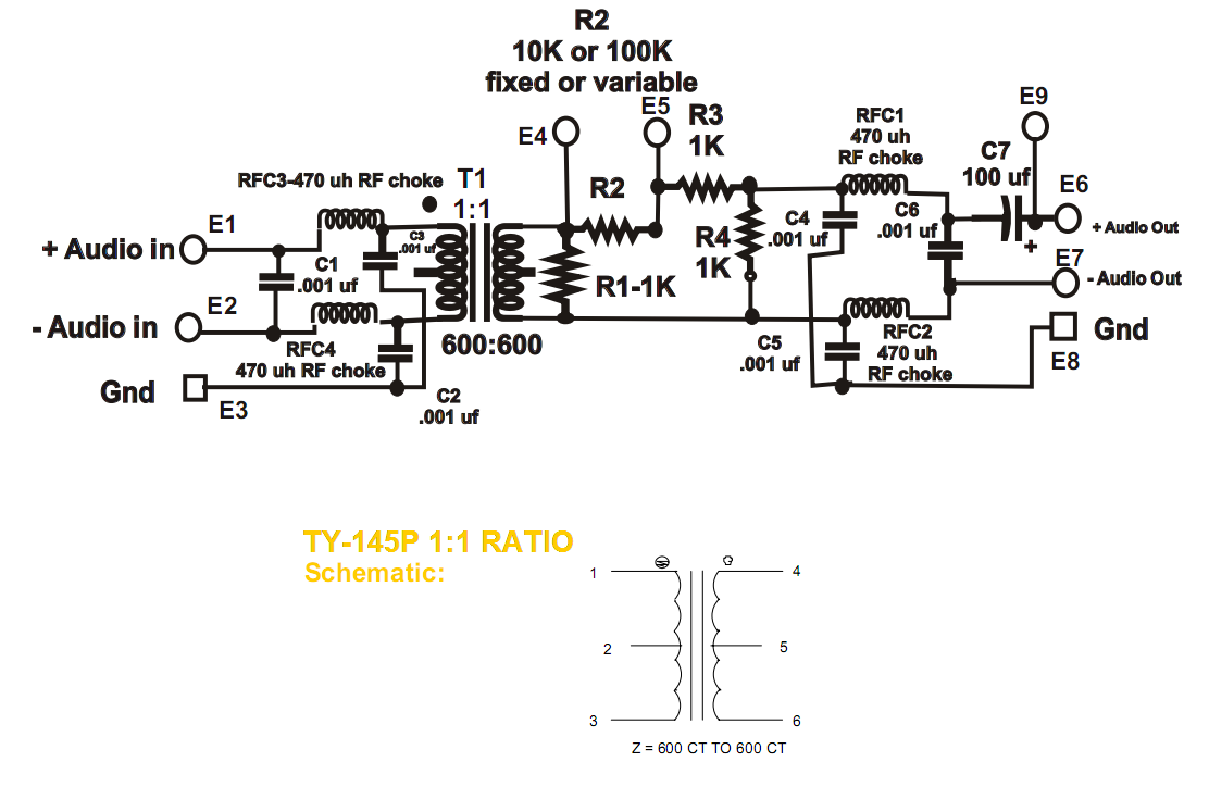

Hi. Could some one please tell me the correct way to connect this TY-145P transformer. I think the dot in the variable audio level schematic
indicates pin 1 start of primary & polarity. But I am unsure of how the other TY-145P pin numbers should be connected .

Pins 1 and 3 are the input and pins 4 and 6 are the output. The dots indicate in phase. Your schematic shows pins 2 and 5 not connected to anything.

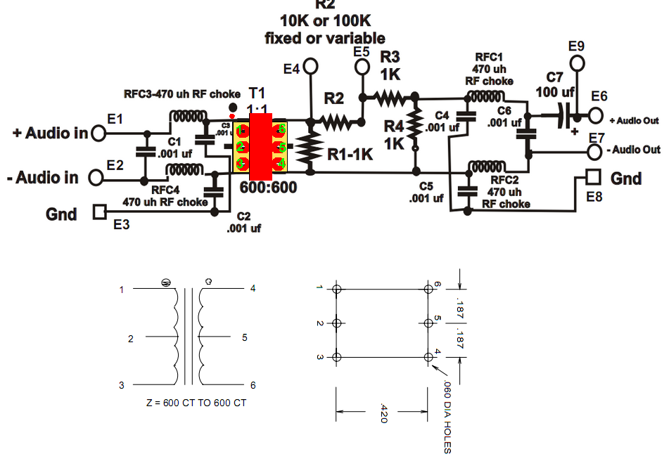

Thanks audioguru , I have attached another pic to see if I got the placement for pcb correct. As the datasheet seems to show its pins on the schematic different to the pin spacing drawing 6-5-4 look reversed on what would be board drill hole orientation.
Dont know if this matters for phase , as these things confuse me.

The pins are numbered in a circle. The schematic of the pins shows that pin 1 has the same phase as pin 4.

Agree, you have to swap 4 and 8 on your superimposed transformer.
Not really - just swap the labels on E1 and E2 :D
Assuming there's any need to swap anything?, it's highly unlikely to make the slightest difference - but you could even put a double pole double throw switch on E1 and E2, so you could reverse the phase if ever required (it's fairly common on mixers, but rarely used).
Big thanks to all who replied, I will swap them round using one or the other suggested methods.
