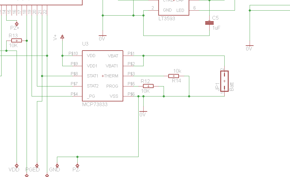

I've designed a LCD watch and had a simple battery charger that would charge the battery, but I overlooked the design and forgot to add a way for the circuit to be powered from the battery. (see schematic)
How to I make the circuit from the battery but also allow it to charge from usb when it's plugged in.
The cahrger (MCP73833) is a constant voltage and constant current charger (currents are selectable) and terminates the charge based on current.

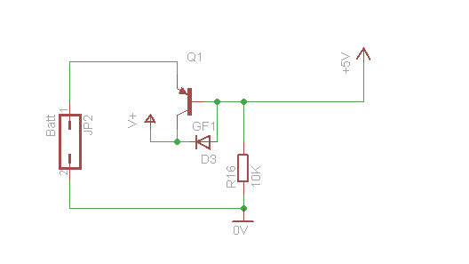

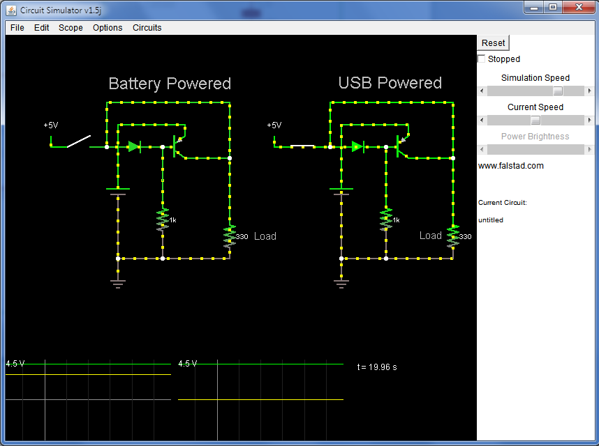

I thought about using a PNP transistor to disable the battery from supplying current to the circuit the moment USB is plauged in (See second schematic) It works in simulation and tested it with a battery pack and usb port. but I'm not too sure how it will work with the charger wired up to it as well.
Can you guys suggest ideas?

The simulation can be seen here [Circuit Simulator Applet]
When the aplet loads, go File -> import and paste this

This is my first SMD Circuit but yes I have built electronic circuits before. The Li+ battery does have a special charger that's what the MCP73833 is.
I wasn't getting any responses so I went ahead with my idea (just two minor changes in the schematic resulted in only needing to solder two components onto the board) and my circuit worked!
It powers from the battery when the USB is not connected drawing an expected 50mA from the battery and when I plug in USB, the current draw drops down to -0.5mA as the charger would be trying to test the battery and the circuit works with out any problems.
A quick note. It's really hard trying to find a schematic or a article talking about live switching from battery to external power so that's why i wanted opinions on this.
I have attached a schematic of the circuit I'm using in case anyone else wants to use it in their circuit.
+5V - Power from USB
V+ - Goes to Voltage Regulator or your load
Batt.1 is Positive
Batt.2 = negative
the 10K is a pulldown resistor
the diode stops the Base of the transistor going high when the battery is running
The Transistor is a PNP in case you didn't notice =]

If I understand this correctly, you are trying to use the PNP to disable the battery while it is charging correct? If you entire watch is powered off of the battery then why not just connect all of the other components to the batteries terminals? It is a 1A charger and there should be plenty of power left in the circuit. I made a circuit a little like this for a radio of mine (that's still being put together), but in my design once power is applied to the circuit, then the battery monitor (your Lithium battery should definitely have one) disconnects the battery from the load as soon as charging power is applied. For my battery monitor I use an ICL7665, so to disable it, I used a 2N3906 PNP with a diode on the base connected to the main voltage supply, and a 10k resistor to ground. Like what your doing in your circuit (by the way, your diode is backwards).
Hey Dragon Trainer,
I thought my battery charger did disable the battery once external power was applied but when I tested it, didn't work. So that's why I cam up with the PNP transistor idea. Also I'm sure the diode is correct, if I reverse it, the USB wont be able to power the circuit
