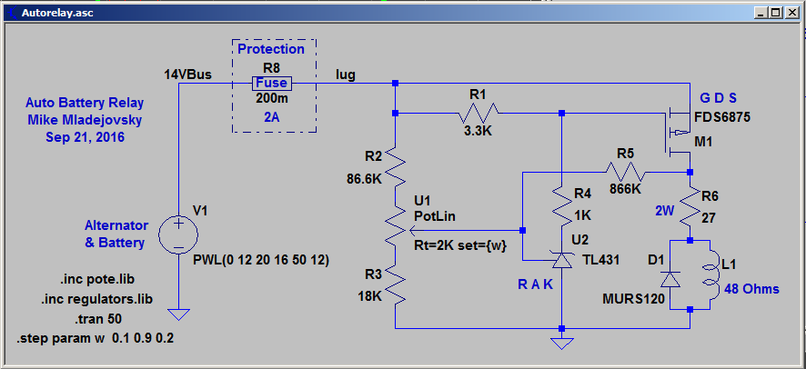

I put this circuit in my Chev PickUp. It detects when the engine is running (Vbat>14V), pulls in a relay, and connects an auxiliary battery (used to power ham equipment) in parallel with the main starting battery. Relay drops out, isolating the two batteries when the vehicle is parked, preventing discharging the starting battery if I want to use my radios while parked.
The relay I used was a special one that required the series resistor R6 (27Ω). If you use one of the automotive "sugar-cube" relays, then you can leave out R6. The trip-point is adjustable. The circuit has hysteresis.
Should work for your application if you use the normally closed contact of the relay to break your starting circuit (not ignition). With the circuit active, the starter will not crank if the charger is plugged-in. However, if the charger is unplugged beforehand, the circuit will allow the starter to crank. You cannot break the ignition wire, otherwise the circuit will detect the elevated voltage, and the engine will die again as the alternator comes on-line.
With the added advantage that the engine won't try to crank when it's running.

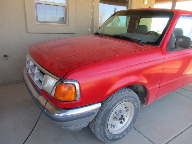

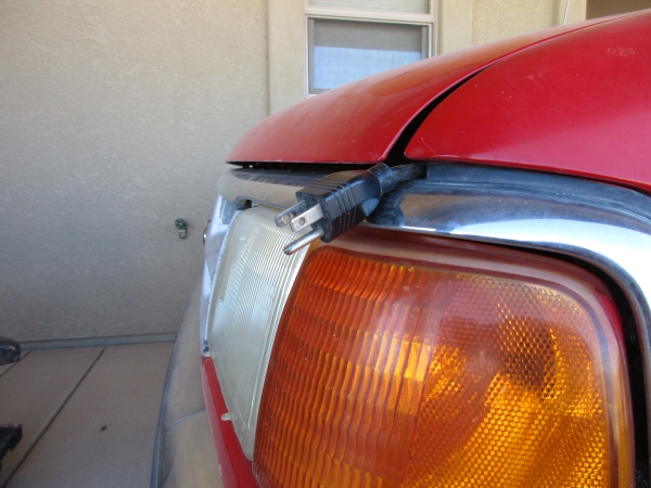

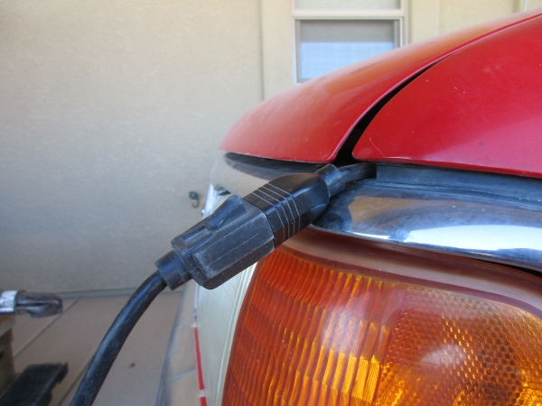

Around here everyone plugs their vehicle, and most any machinery with an engine, into "shore Power" as you call it in the winter to run their engine block heaters and the simple solution to not driving away while still plugged in is to wrap the power cord around the drivers side door handle, mirror or window wiper so they can't miss seeing it when getting in.
If a person is so oblivious to that sort of obvious details around them they probably shouldn't be driving at all.

It occurred to me that I had solved this problem another way. Think about what happens if I jump into my beater farm truck without unplugging the float charger , and back -up (it has happened, several times)!
