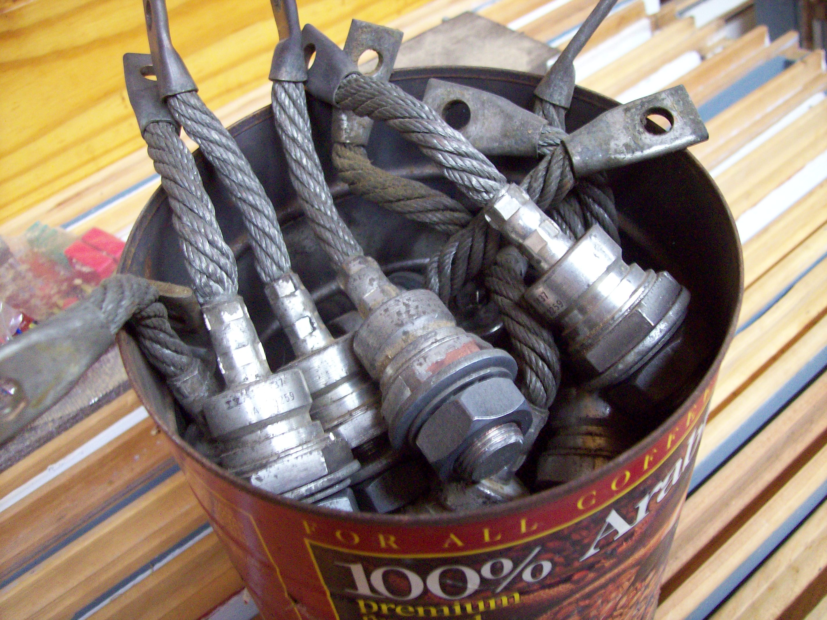

I need 2 of those CM600MA-24H IGBTs.
Do they need a heat sink or some type of water cooling?
How can I drove 2 of those at 60 KHz to 100 KHz?

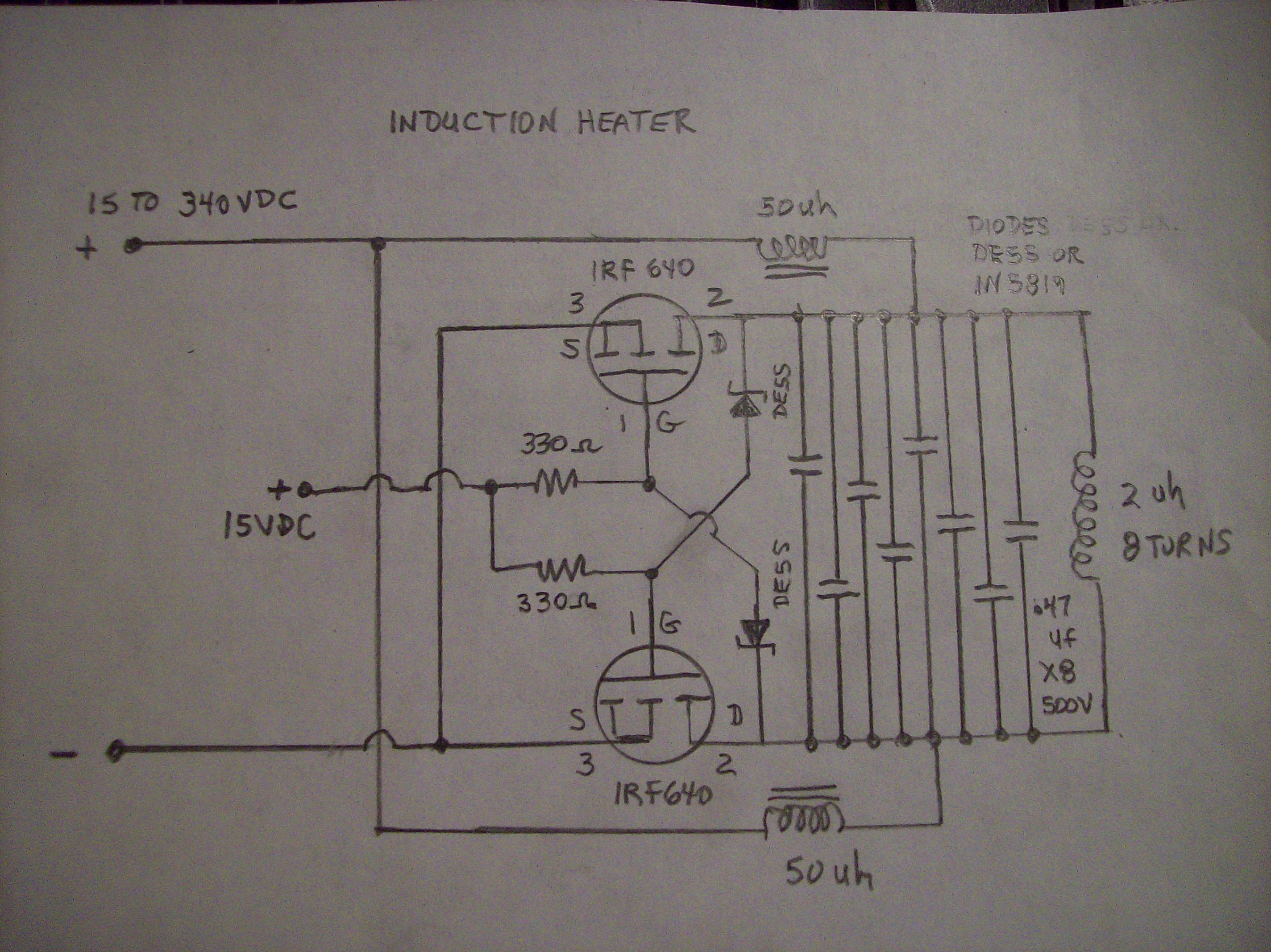

I decided to put my dead circuit back together, replaced the mosfets and replaced the 7812 with 12 VDC of AA batteries. The gate has 12.56 VDC with the circuit ON voltage does not drop or fluxuate it holds at 12.56 VDC all the time even with both loads.
With the original LC coil 7/8" inside diameter, 1.250" long, 8 turns, current is 6a with no load, 26a with the 1/4" steel rod, and 33a with the 3/8" rod. Current is down 4a and the rod no longer gets red hot is 12 seconds, it took 30 seconds.
With a new LC coil 1.125" inside diameter, 1.250" long, 8 turns, current is 4.5a with no load, 15a with the 1/4" rod, 21a with the 3/8" rod. After 2 minutes the rod was just starting to get red hot.
Looks like I am going backwards not forward.

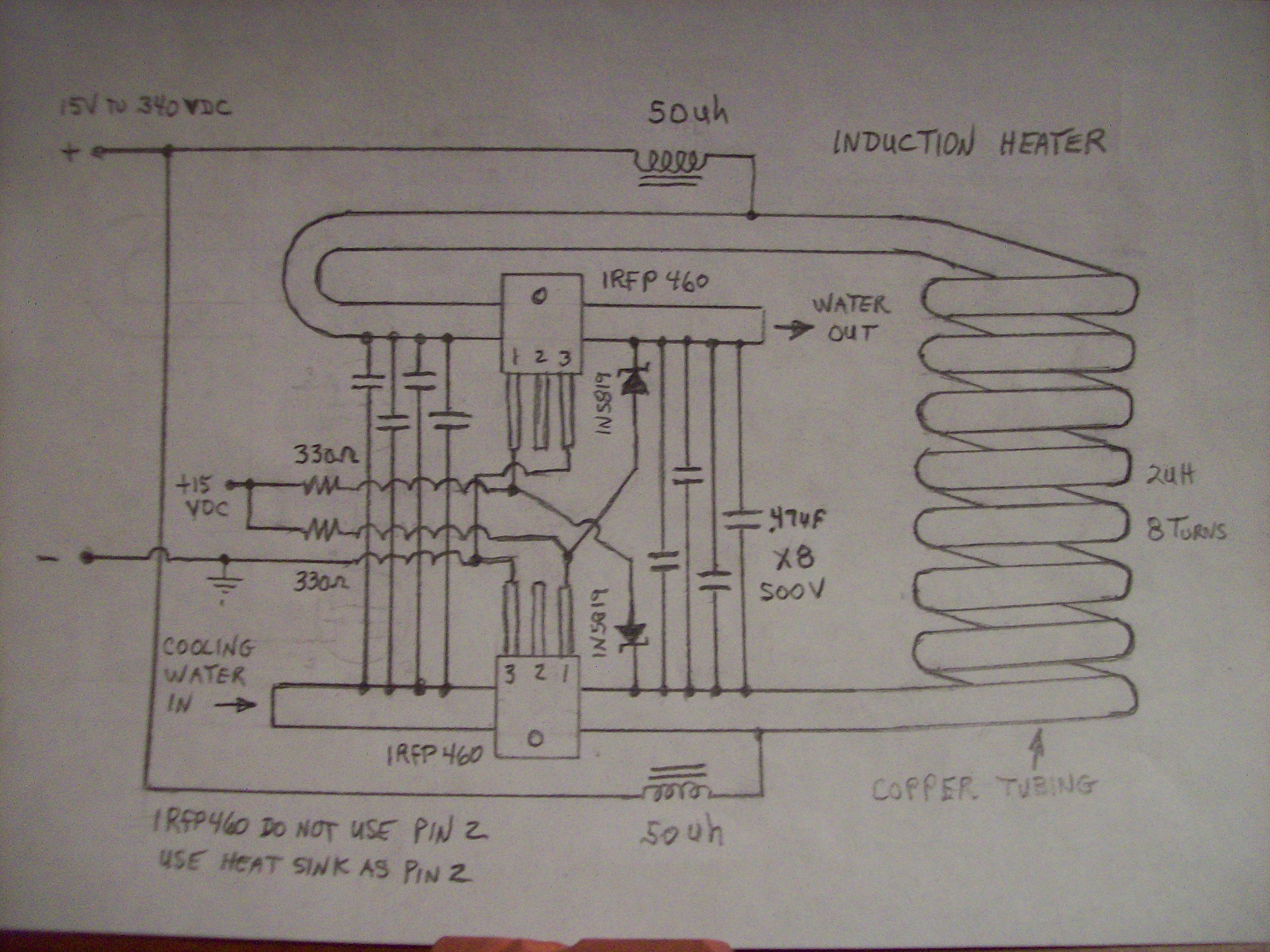

I have my original circuit back together for the exception of the 7812 voltage regulator which was replaced by 8 AA batteries to get +12.56 VDC. Maximum power has dropped from 36a to 32 amps. The 3/8" steel rod no longer heats red hot in 12 seconds, it now takes 29 seconds. How much power goes through the gates and ADDS to the total power of the LC coil? I am trying to understand why power and performance has dropped?
At this point I suggest reading and studying everything in Mosaics last link in post 43 in detail.
It's probably the most thoroughly explained DIY induction heater builds I have ever seen!
Darn near makes me want to build one.
No power goes through the gates to the coil.
The 220 ohm gate resistors consume about 0.3W each.
Are the new FETs of the same type as in the original circuit?

I remember this read this long time ago. This guy must have a 100a breaker in his home circuit box he using 120vac changing it to 170vdc then doubling it to 340vdc. This could be dangerious sliging steel rods in the work coil all day. Work coil needs to be insulated with 2000 degree furnace cement. I can not zoom in on this circuit to read part values and some have no values. I build a work coil with copper tubing for this circuit several years ago.
other than skin effect, the primary reason for using tubing, is you can feed water through it for cooling. most commercial equipment does that. because it's live circuitry, the water has to be distilled water.

I read this entire thread today. Most of this I don't remember. I need to get serious about building this circuit https://www.mindchallenger.com/inductionheater/inductionschematic.gif

I am looking over this circuit some part numbers are hard to read. I already made a work coil few years ago, I need to build a better coil for this circuit. I think heat sinks need to be water cooled. I will change transformer I have to 10.6vac = 15DC 140amps. I have 250 amp diodes they need heat sinks too..
