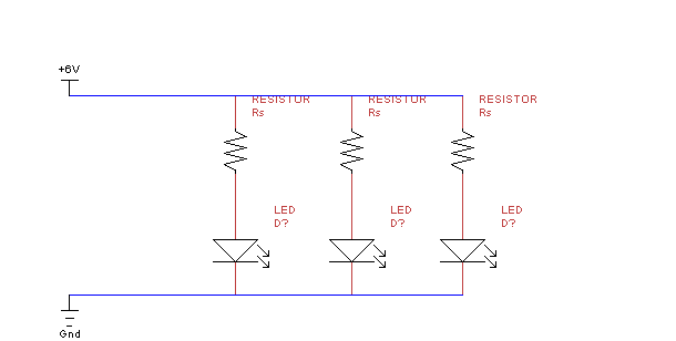

how do I Use flash LED on direct 6VDC motorbikes
mamun2a
Hi every one I;m new here.
I want to use flash LED light with motorbikes engine current (6 V, amp is unknown but guess its over1.5 amp to 5). can any one tell me how do I down the high current flow to save the LED's from burning??
:confused:
You will need to include a resistor in series with the led(s).
LED's use a specific voltage (dependant on the colour, type)
So what you need to do is use the formula below to work out what resistor you need.
Series resistor = supply voltage - led voltage / led current
In your case supply voltage = 6v
led voltage = You can get this information from the supplier of the led's though generally it's Blue led = 3.5v, white led = 3.5v, red led = 2.3v, orange led = 3.8v, green led = 3.4v (these are for hi brightness led's)
led current = usually 20mA for most hi-brightness led's (this = 0.02A)
So for a blue led on 6v, you'd do this:
Rs=6v-3.5v/0.02=125:ohm: closest higher value is 150:ohm: so you'd need a 150:ohm: resistor
but you need to check what the voltage drop of your particular led's is. If you want more than one, it's best to wire a separate resistor for each led. see the diagram attatched

dear do u tell me, Why I found 15-17+ volt with my general (chinese) multimeter when engine starts, what volt actually comes out?
It sounds like the power isn't regulated and can range from 6V to 17V. I don't even know if a flshing LED can stand the higher voltage. You need a constant current source like the LM317, the circuit is on the datasheet which can be found from Google.

To be honest, I'd use a regulator to supply the power to the LED circuit. You can either use a LM317 (as Hero999 suggested) which is a varaible voltage regulator capable of supplying up to 1.5A, or something like a 7806 (AN7806, BA17806T, H7806A etc) which is a fixed 6V regulator. this will be capable of supplying up to 1A. Either should be sufficient to power quite a number of led's, but the fixed regulator needs no other components.
