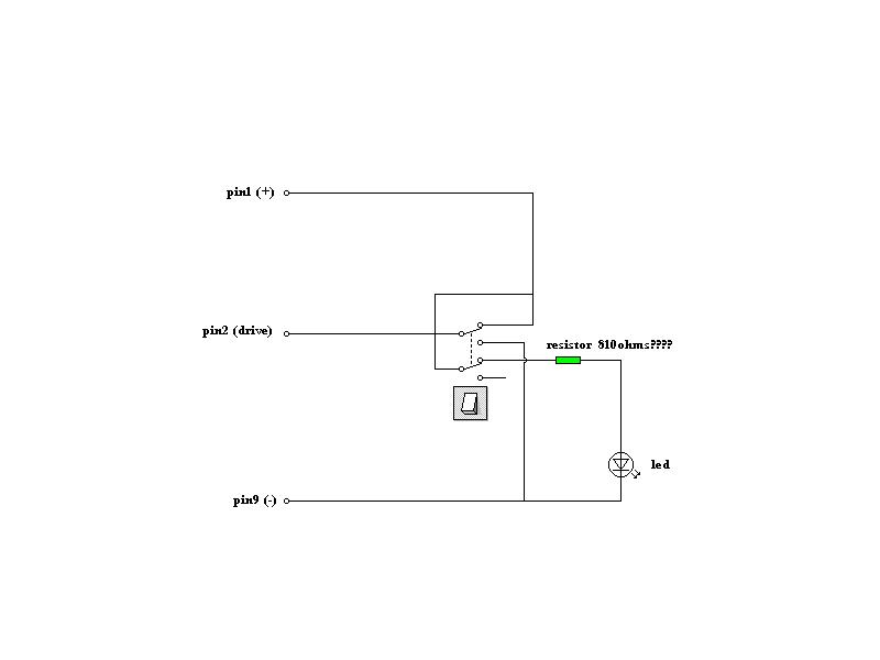

I am building myself a foot controler for a "swr mo bass amp"
see: (http://www.swrsound.com/products/proseries/mobass.html)
(http://www.swrsound.com/products/proseries/mocontrol.html)
I only want the bottom 6 switches with led's.
It hooks up the the amp via db9 connecters.

now... the switching occurs like so (pin 1+ pin 2=drive on)
(pin 9+ pin 2=drive off)
OR... (pin 1+9)+pin 2= effect on/off via a momentary switch.
ie. push the switch once the effect goes on, press it again the effect goes off.
see?? Great!!!
Now HERE is where I am stumped!!!!\
How do I wire up an LED into this mess so that the led lights up when the effect is on and shuts off when the effect is off?
If I hold an led to pin 1 and pin 9 it will light up but I have no Idea how to get the whole thing to work together.

Sounds to me, like you need a flip-flop... schematic to come a bit later (after I think about it a bit :!: )
I'm not quite sure I understand the switching. Are pins 1 and 9 power rails (positive and ground)?
Do you mean that you are shorting pins 1,9 and 2 together? Not possible if 1 & 9 are power rails (dead short between rails = KABOOM)
Can you explain this switching a little more thoroughly?
that is exactly what I am doing
It is exactly like I said, pin 1 and 9 spliced together and momentarily touching pin 2-8 to THAT lead switches the effect on or off.
What also works is pin1+ pin 2-8 will switch the effect on and pin 9 + pin 2-8 will switch the effect off.
Yet another way that also works is touching pin 2-8 to the housing of the db9 conecter I am using which I would assume is ground.

Where did you get the pinout from? like phasor said if 1 and 9 are part of the supply shorting these out could knacker the amp - although maybe a current reg or resistor has so far prevented this!
Anyhow, looking at the 'mo control' if that is the correct unit looks like to me as if there is definately logic control in there - especially considering you can 'group' the effects and seeing also that the buttons appear to be simple contact switches - my approach being so inclined would definately be microcontroled as I think this would be the simplist way to implement such asystem. DPDT switches like so...
Not sure if this would work without knowing more but sounds to me like logic 1 on logic 0 off you may also need resistors before the output.
Also if you shorted supply out that suggests to me that it can't source much current so maybe up the resistor to 1k for the leds.
I forgot to mention that you would need to copy that circuit for each effect.
